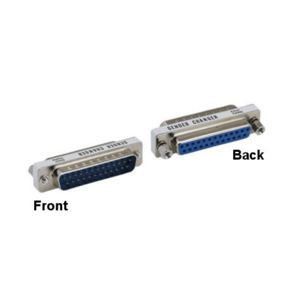

Posted by: Phipli on 2022-11-26 02:17:25
I think you can just use one of these :
No, I don't know why they exist either 🤣
Posted by: jeremywork on 2022-11-26 02:25:27
To make your cables fit together 😉
I've used a *Parallel SCSI zip drive for not having had one of these handy in an instance or two.
Edit: I remembered the SCSI version is F-F, long time ago now. This wasn’t recommended really and probably has caveats, but it was free ewaste at the time
This is what I did. 1 or 2x straight through gender changes attached to my older 25pin SCSI2SD did the trick.
