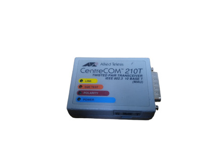

Posted by: Lopan on 2023-02-11 11:27:14
I just got my se/30 working with this. funny thing is I used to have 50 of these and got rid of them
Posted by: cheesestraws on 2023-02-12 03:03:01
That’s the same one that I use, too
Posted by: j2theLj on 2023-02-12 11:21:36
I found one just like it too and it works great.
