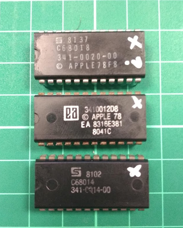

Posted by: bibilit on 2024-06-19 11:22:29
I managed to build a socket adaptor for testing purposes (ugly but works)
Using a known bad Rom, it was read ok and comparing it with a good rom .bin image, i know now for sure is bad.
