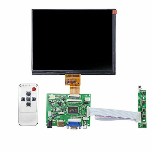

Find many great new & used options and get the best deals for HDMI+VGA+AV Control Driver Board + 8"inch HE080IA-01D 1024*768 IPS LCD Display at the best online prices at eBay!
www.ebay.com.au

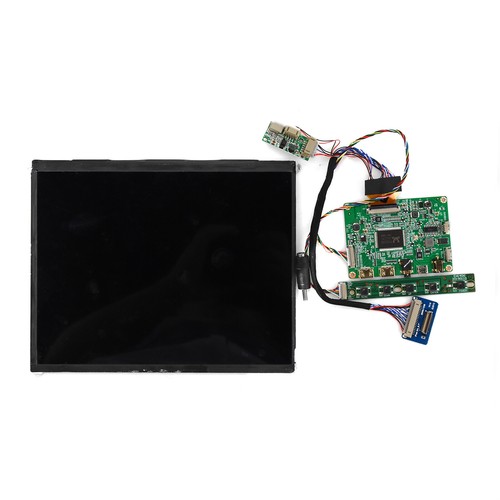

Find many great new & used options and get the best deals for 9.7"IPS LCD Screen+MINI HDMI Driver Board Kit LP097QX1-SPAV 2048×1536 eDP 51pins at the best online prices at eBay!
www.ebay.com.au

Posted by: Scott Squires on 2022-11-19 00:08:40 I did a bunch of panel shopping last year and decided HJ080IA-01E to be the best option for physical size, resolution, availability, etc. I was planning to make an lvds driver circuit for it but haven't yet. It would be perfectly fine paired with an hdmi driver board and rgb2hdmi as well. |

Posted by: Byrd on 2022-11-30 16:27:21 Thanks all for tips - @Scott Squires that does looks like the kind of cheap and nasty LCD I could work with! Looks like it can be picked up for $60 AUD with controller, thank you |
Posted by: davidg5678 on 2022-11-30 16:40:16
HJ080IA-01E Coincidentally, I've been playing with the exact same LCD panel recently. On eBay, it cost me about $37 USD shipped from China, so it was a pretty good deal. I think that the screen's IPS panel looks very good, especially for the money. Even though the resolution is relatively low, it works out okay because the physical screen size is small. I haven't yet had the chance to see how it would look inside a Macintosh bezel as I am using it to build one of these: https://www.thingiverse.com/thing:4846997 |
