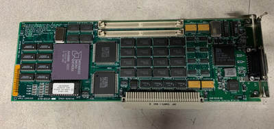

I have brought out my bin and photographed some of the cards I’ve pulled out of random machines I’ve bought over the years. I likely have a bunch more but are more inaccessible. Please help me identify some and also provide info as to whether they are useful or good, or not. Thank you !
CA2584BA-EF85-47C9-B835-625C37AB0447.jpegDDAEF46C-903E-47C2-BF86-916A49134938.jpeg1F67FBA0-7CEA-4EFC-93FA-AA3213FBE1B8.jpegD60B41FE-FC8C-492D-AABB-844B5E746FC1.jpeg8FA2D695-D93B-40B4-995F-15F45729060D.jpegE707A932-91C0-4EE0-8148-B40E3AE61DDD.jpegFC1C207E-1927-4126-9361-F838452AE5F4.jpeg3641B083-A217-4401-9FE7-47095C783D77.jpeg383DB96B-E206-4EFB-AA6B-8C5E033777ED.jpeg34503470-DEDC-4661-99D1-1FA77FA7E0F4.jpeg6A9DBD36-C0C4-4131-9964-1C25AFF49707.jpeg1F47C3AD-62FF-4271-87DB-F8B145D8B7D5.jpeg70806BBD-898C-443A-84B6-4D35D20830EE.jpeg8C61E7F9-5D3F-41BF-961F-31531C4D40AD.jpeg45EEAF29-6E55-41B5-9D7C-0FCC95F485FC.jpegA422DAFC-60B7-4CE7-8067-F796D11A436E.jpeg35BFEF70-EE09-4CE3-96A7-219E3ACDA372.jpeg

A starter for ten, perhaps useful:
The 8•24GC was a banger of a card when it was new Might still be the fastest card fully supported under System 6 (?). Is picky about System verrsions, I believe. Not sure, haven't got one. Nice, though.

Posted by: ArmorAlley on 2022-10-22 11:06:16
Radius Two Page Display graphics card from 1988. It was designed for the Mac II.
You have struck gold here. This is the famed Macintosh Display 8 24 GC card. It is sought after by IIfx owners.

Posted by: olePigeon on 2022-10-22 11:08:52
I was half way through identifying the cards when Cheesestraws beat me to it. 🙂
Of your cards, I think the most valuable are:
8•24 GC and the AST Mac286. They seem to be coveted amongst a select group of enthusiasts.
However, I believe the regular 8•24 is a fine card if you already have an 8•24 GC because (I think) the GC card will accelerate it. So I'd keep those two cards together.
Posted by: slomacuser on 2022-10-22 11:46:03
Well the one 8•24 GC sold on ebay recently fetch only $85 …
