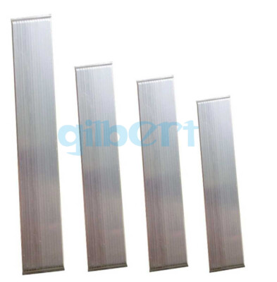

Posted by: ymk on 2022-06-19 14:00:09 Cooling the 486 is a better bet than the SCSI or ethernet chips.
If there's little clearance, vapor chambers are good at moving heat sideways:
Apply to CPU Radiator And LED Computer etc! Wick Structure:Groove. Length:100mm,110mm,120mm,130mm,140mm,150mm,160mm,170mm,180mm,190mm,200mm,210mm,220mm,230mm,240mm,250mm,260mm,270mm,280mm,290mm,300mm,310mm,320mm,330mm.
www.ebay.com
Thick foam weatherstripping can be used around the PSU fan, under the case, to direct the air to the rear.
Otherwise, the exhaust heat can be reabsorbed through the case floor.
