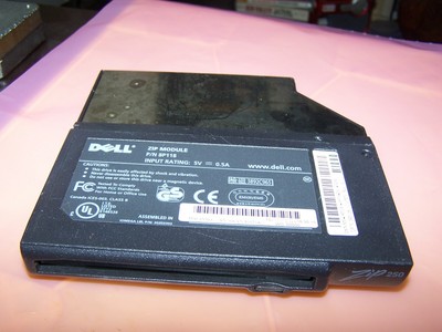

Posted by: ried on 2022-05-23 19:15:50 Well, I can confirm that this model of Dell expansion bay Zip 100 drives requires a lot more than a housing swap.
Find many great new & used options and get the best deals for Dell laptop internal ZIP drive P/N BP118 at the best online prices at eBay! Free shipping for many products!
www.ebay.com
Disassembled both. The removable green connector board on the back of the G3 unit does not fit the Dell drive. They are similar, but different connectors. Still investigating. |
Posted by: mg.man on 2022-05-24 10:59:38 Umm... that's a Zip 250 Dell drive. I've successfully swapped for a Dell Zip 100, no experience with anything else. |
