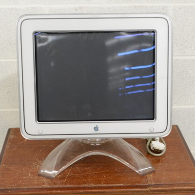

Posted by: Nifty950 on 2022-04-26 18:41:19 speaking of ADC Display take a look at this
Tested and has a very nice picture! Crack on the Apple emblem. Light scratches on the chassis may also be present. Very heavy. Local Pickup.
www.ebay.com
Is that CRT really just powered by the 25V ADC Port? I have a hard time believing that. theres got to be AC power input somewhere on that CRT. A CRT Requires Alternating current to function! |
Posted by: jeremywork on 2022-04-26 18:51:19
www.ebay.com
Is that CRT really just powered by the 25V ADC Port? I have a hard time believing that. theres got to be AC power input somewhere on that CRT. A CRT Requires Alternating current to function! Nope, all over ADC. IIRC this one can draw up to 117 watts, which *will* push the PSU over its limit if the machine already has the full extent of available bells and whistles. |
Posted by: Nifty950 on 2022-04-26 18:53:22 I wanted to get that but it seems to me that if I ever have to ATX mod my G4, then that monitor becomes useless. Or if I ever want to upgrade the video card with a flashed one. Surely I could just get a trinitron and be just as happy? |
Posted by: jeremywork on 2022-04-26 19:01:18
I wanted to get that but it seems to me that if I ever have to ATX mod my G4, then that monitor becomes useless. Or if I ever want to upgrade the video card with a flashed one. Surely I could just get a trinitron and be just as happy? Probably true, if you don't mind the aesthetic.
There were adapters sold by Griffin which allowed a VGA input, USB, and standalone power cable to enable use of one of these. The DVI based ones made by Apple will only work with the ADC flat panel displays. |

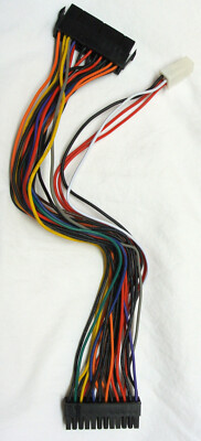

Posted by: sos_nz on 2022-08-09 02:53:39 Bit late to the party - but yes, someone is!
Shop for Apple PowerMac G4 MDD ATX Power Supply Adapter Cable. Perfect for upgrading your system with 400W of power. Compatible with MDD G4 models.

Posted by: Trash80toHP_Mini on 2022-08-09 07:45:49 Glad to see that cable is available again, even if it is implemented in straight wiring. The originals were built on a jig so as to match the twists and turns of the OEM part. I've got pics of the jig somewhere, might be useful if only for torquing the straight build into shape? |
Posted by: sos_nz on 2022-08-10 02:56:30
Here's some from the atxg4 site:
If I ever do this, I'll jig it up and heat shrink for tidiness (and because I'm OCD, likely wire in a voltage up converter to get a proper 28V feed). |
Posted by: Trash80toHP_Mini on 2022-08-10 08:57:13 Thanks. Out of habit, I back up anything I might be remotely interested in doing. Web pages are ephemeral, so far only one of my HDDs has been and that one I screwed up myself trying to run a G3DT off my G4 boot disk. Ignorance of partitioning constraints is not an excuse. 😳
With OEM cable in hand and a bit of scaling in AI, I figure that jig would be easily reproduced. Never got around to asking for dimensions, meant to do that when his cables went out of production before I could snag a set. |

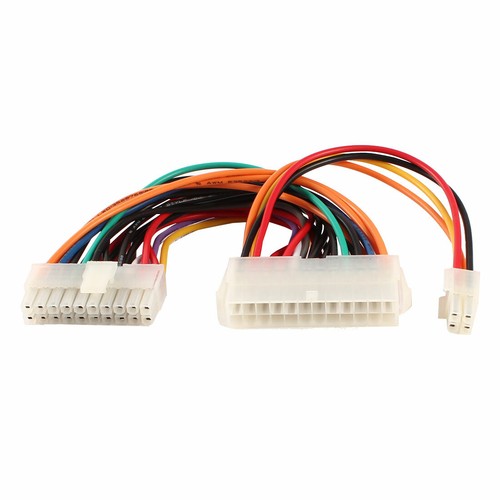

Posted by: Phipli on 2022-08-15 04:47:16
Find many great new & used options and get the best deals for ATX Male to 20+4pin Female PC Power 24 Pin Adapter Extension Cable at the best online prices at eBay! Free delivery for many products.
www.ebay.co.uk
I'm planning on rewiring one of these. I got an old fashioned multicoloured one to reduce the chance of making an error, most are monochromatic these days. |
