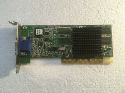

Seems any good PowerPC compatible “Mac Edition” AGP (and PCI) video card (64GB, 128GB etc) out there are exponentially higher in cost than their PC counterpart. (See example below).
Is there a way for an avg user/layperson like myself to make one of these work in, say, a G4 GE?
If so can someone point me to a tutorial?

You can find a list of available Mac video GPU ROMs here.
As you can see, some cards have a "reduced" ROM (no boot screen, card starts with OS) which can be flashed onto the PC cards' smaller flash chips. Other than that you will have to replace the flash chip with one of a higher capacity. I have done this on quite a few PCI Radeon 7000s as those cards can be had very cheaply and have DVI, VGA and S-video. You can flash the AGP R7000s with the same ROM.
You'll need to use a utility like flashrom, nvflash or atiflash to re-flash the ROM chip. Alternatively you can flash the chip with a specific tool for doing so, although those are expensive. Some cards have write protection on them so the latter method is sometimes the only way.
Here's a sample tutorial.

Adding to CircuitBored's splendid post, you ideally need an old Pentium II or III working setup to adequately flash the cards. Look for x86 versions of the cards that look roughly reference in design, or similar to the Apple OEM cards. Look for good quality brands and cards (not low profile, not hobbled 64-bit cards with crappy slow RAM speeds, with good fans and heatsinks).
The card you have indicated won't flash over easily IMO - Radeon 7000 is the easiest, maybe Geforce FX5200 cards second.
