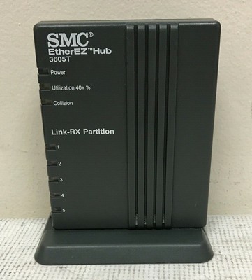

Posted by: mikkel2326 on 2022-04-03 07:08:54 These responses are really helpful. Regarding the hub, would something like this be a possibility?:
SMC EtherEZ Hub 5-Port 10BASE-T Ethernet Hub 3605T
Find many great new & used options and get the best deals for SMC EtherEZ Hub 5-Port 10BASE-T Ethernet Hub 3605T at the best online prices at eBay! Free shipping for many products!
www.ebay.com
If any of you are wondering why I am bothering with such a fiddly solution as the AsanteTalk, several years ago, before i got this recapped SE/30 board, I used a MacCon IIsi-SE/30 Ethernet Card, which worked fine. When I try to use it in the 'new' board, I get a screen that looks like SimiSimac, so I abandoned it as I had the AsanteTalk bridge available. I'll revisit the MacCon eventually, it sounds like a better solution.

Posted by: mikkel2326 on 2022-04-06 11:40:08 Success!! @robin-fo 's guidance regarding the 10base t hub did it. I was able to daisy chain the hub off of my existing gigabit hub and things started showing up. Also, @mactjaap 's MacIPgw 800k floppy image booted by my FloppyEMU gave me the correct info to put me on the right path.
