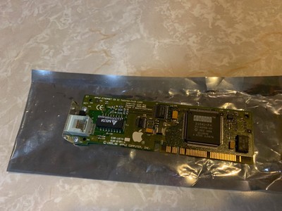

Find many great new & used options and get the best deals for Apple Comm Slot II Twisted Pair Ethernet Card at the best online prices at eBay! Free shipping for many products!
www.ebay.com
Posted by: alectrona6400 on 2022-03-29 06:14:48 Yikes. I'm planning to put a Radeon 7000 into my 6360 yet also have some form of ethernet connection. Not sure if that'll play out at all... |
