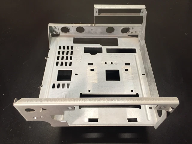

That is odd, because, officially, every part should be interchangeable on those...short of the PDS cards made for each. That's what I thought too! However the SE/30's case does seem to be slightly different (picture found from here:
Namely, the SE doesn't have an opening for the PDS card, and the slot for the PSU cable is much smaller.
Posted by: rjkucia on 2022-03-29 11:54:19 Here's the SE chassis as a comparison

does anyone know if it fits on the SE front panel? Yes, the "SE/30" chassis will fit a SE front panel just fine. Also... there is a later "SE" chassis that has a PDS slot opening. That one should also work fine with a SE/30 'board - BUT, if you're planning on connecting something (vertical) to the SE/30 PDS, you NEED a SE/30 chassis - the PDS 'slot' in the SE chassis is smaller. đ
