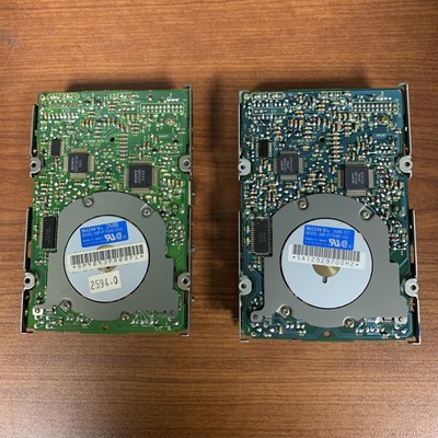

Posted by: RadRacer203 on 2022-01-29 15:11:14
Yeah I have that also. I got the complete set from an absolutely trashed SE Superdrive. Managed to find a drive that works with this on my shelf, just has the usual broken eject gear
