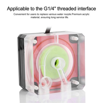

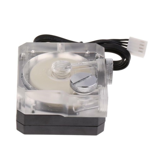

... ideally, I'd like to replace the pumps with new - there isn't much available, and Laing DDC branded pumps are really expensive (AUD $150+/pump), I found these substitutes (reportedly PWM compatible but also with standard molex connectors):
Find many great new & used options and get the best deals for SC-P60A 450L/h Computer Water Cooling CPU Pump DDC Water-Pump DC12V Transparent at the best online prices at eBay!
www.ebay.com.au
Find many great new & used options and get the best deals for 12V DC Water Cooling Pump Acrylic Heat Sink PWM Speed Control for Computer at the best online prices at eBay!
www.ebay.com.au
I suspect running these off the Apple pump harness won't be great, I'd be happy to run them off 12V tapped elsewhere, with a third party PWM controller to slow the pump down.

Posted by: Byrd on 2021-12-22 13:48:39 Sounds like the answer is: no-one really knows.
I've enquired about the DIYINHK replacement pump PCBs for the Laing DDC, their answer was "it may or may not work" 😕 so I'm going to purchase a few SC-P60A pumps, fittings and try my luck. These pumps will fit well and have a port for filling; anything that can replace the horrible OEM parts will be a help. |

Posted by: Byrd on 2022-02-12 22:08:27 After some trial and error I have the Syscooling SC-P60A pumps installed - they are a similar design and output to the OEM Delphi pumps but shorter in height, they are mounted on ~ 25mm high density EVA foam blocks and adhesive foam to reduce noise and vibration. The Syscooling pumps are of good quality and sealed design.
With bench testing, so far so good - the pumps work quietly and while bleeding the system for air bubbles can take time, having a small inlet port to funnel in coolant in is rather useful. I've used a small fan controller and found they keep pumping without issue @ 3 - 12V, but are quiet so will just leave at 12V unless the loop requires more slower water flow for adequate cooling (assume analogy of pumping a garden hose through a straw).
Next up is to run them off 12V in the Quad and see if I can calibrate the Mac without PVM sense lines; these pumps are PWM but I'm quite sure Apple's implementation of this won't be the same.
