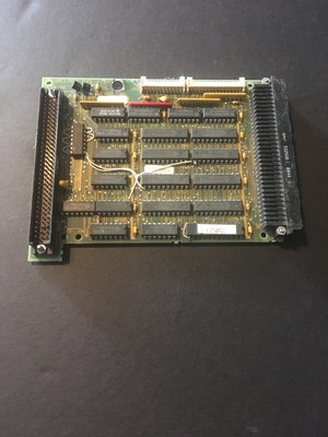

Posted by: cheesestraws on 2021-08-25 05:15:57 The docking equipment for the Outbound Laptop consists of two parts: the PDS card and the cable that goes from the PDS card to the back panel of the machine to provide the external port (28 pin mini-centronics style). Does anyone have a good photograph of the cable part of that? |

Posted by: cheesestraws on 2021-08-25 14:17:00 I might have actually bought the one on eBay, but not for $250... heh.
The things that convinced me were firstly that the pin headers on the top of the card had the same number of connectors as the cable, secondly that I realised that the second PDS connector was literally just that, a second PDS connector to make it easier to install in both styles of SE, and thirdly that the manual talks about a cable to the back of the machine, not a complex daughterboard that would need mounting.
The card seems to consist mostly (it hasn't arrived yet) of 74 series logic, which bodes well for the Clever Stuff being mostly done laptop-side. If that's the case I have some hope.
I should add that I have the docking cable that goes from the SE to the laptop, so I can have some confidence in everything up to that one missing link. So perhaps it will be reverse-engineerable.
But a photo would be handy. |
Posted by: trag on 2021-08-25 15:33:21 Here's the one on Ebay I'm thinking of:
<p>Rare Vintage Nubus Board For Mac Dock SE Wallaby Sys Made In USA.. It's written in the lower left corner : Dock SE which means : The upper connector is design to connect the missing sub-board of daughter board and the Dock SE connector means to connect to the MacSE mainboard... Shipped with...
www.ebay.com
I offered the seller $110 near the beginning of the listing, which was immediately rejected. I've been considering offering it again, but just as well if a fellow list member got it.
If you are willing, I'd enjoy knowing what you ended up paying for it.
I could have sworn I had a copy of my notes on teh web, but I guess they're on the main archive at home. The connector for the Outbound is a Hirose DX something or other. If you need I'll try to remember to look at my notes. It's not actually a mini-centronics...
The last time I looked it was still in production, but not easy to find.
Unfortunately, that doesn't tell you in what order to connect the wires.
However, it'll be interesting to trace where that connector goes on teh board once you get it.
The SCSI adapter and the external Floppy adapter both have an 85C30 as the first component after the cable connector.
So if the docking adapter connects in an analogous way, there may be an 85C30 on the board just before the cable connector, in which case we may be able to figure out the wiring by example.
Later Edit: Well carp. I took another look at the image in that auction and I don't see an 85C30. Ah well. |
Posted by: cheesestraws on 2021-08-26 03:09:09 If you can find your notes, that would be incredibly helpful to work out what the actual connector is. Though even knowing it's a hirose DX of some description is handy: I got as far as "like AAUI but wider" and that was as far as I got.
Working out the pinout is going to be tricky. I suspect that to do so will require mapping out quite a bit of the circuitry on that card, but it looks like it's probably manageable even with my dubious talents. I cannot tell you how much I am hoping that it has at least two ground pins arranged in such a way that they're geometrically unambiguous :-D. Though I doubt it - there aren't many terminals on that connector.
That's a twist I wasn't expecting, so presumably there's some kind of mode switching from serial to something else involved, which is going to make this more complicated. I sort of assumed it was just a horribly multiplexed PDS slot, but, hrm. |
