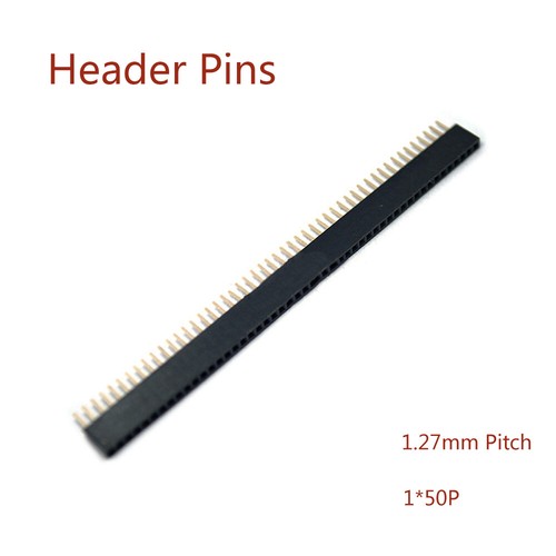

Thought you might be interested in seeing my alternate plan of attack for connector interface? Have you looked at the missing PDS signals on MagicBus? Very curious about what's required and what's not for a video only setup, Was surprised to see full Address and Data lines implemented on a single bit VidCard. But that would be necessary for video buffer memory mapping I'd think?
Thinking I'd go from two layers to four given trace spacing required. I'll start a new thread about extending the bus, but I'd like my MicroMac Performer build to include MagicBus FPD/TPD Card compatibility along with full PDS support for DCaD playtime. | Posted by: Trash80toHP_Mini on 2022-05-01 18:35:06 @cheesestraws Looks to me like two rows of 1.27 pitch header sockets set parallel to J2A ought to suffice for a KISS MagicBus connector bodge? Maybe not?
1x50P Single Row Header Pins Socket 1.27mm Pitch PCB Female Connector Straight | Business, Office & Industrial, Electrical Equipment & Supplies, Wire, Cable & Conduit | eBay!
www.ebay.ie
Not sure, I nave some some 2x5 double row sockets with that pitch which line up legs-to-sockets on J2A, but I can't get it to seat on a TPD card's pins. Could be the double row/wrong row spacing interference thing? But I have a sneaking suspicion that the pins on the OEM part don't match that header/socket spec for thickness?
