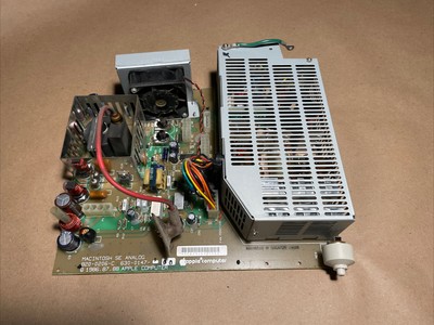

Zoinks, but analog boards aren't cheap anymore 😵 I think I got mine for less than half this BIN just a few years ago. Though I guess the PSU is included...
Find many great new & used options and get the best deals for Macintosh SE Analog Board 820-0206-C with Power Supply 630-0147-C at the best online prices at eBay! Free shipping for many products!

I have a flyback from a NOS amber CRT, but I have neither an inkling of an idea, nor the technical acumen to determine if it's compatible or adaptable. |

Posted by: PB145B on 2021-07-12 10:46:52 I quick search in the completed ebay listing shows two, one that sold for $29.99 and another for $49.95, so that’s probably the realistic going prices. $49.95 certainly isn’t “cheap,” though $29.99 seems like a good deal.
As @dkjones96 said, just keep a look out. You’ll find a deal on one eventually. |
