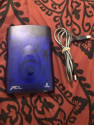

Posted by: chelseayr on 2021-07-10 02:53:18 cheesestraws, well this one;
Find many great new & used options and get the best deals for Iomega Zip 100 USB Powed External Drive Z100USBS with USB Cable at the best online prices at eBay! Free shipping for many products!
www.ebay.ca
has no logo which was why I had wanted to recheck that it wasn't just me as I think that officially it was only usb or usb/parallel and web people just are confused indeed :-s (and like bibilit said re somewhere to set the scsi id as well) |

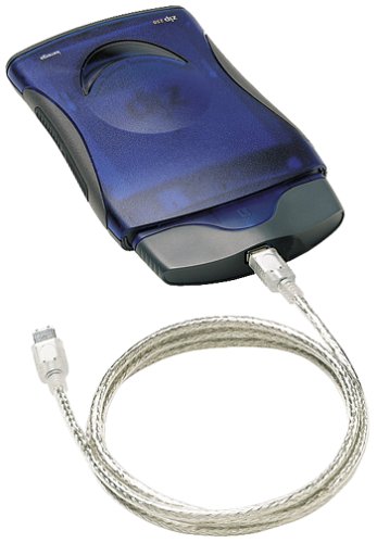

Pretty certain that connector, which looks a bit like SCSI 2, is actually used for firewire and PCMCIA adaptors - this could certainly lead to some confusion.
edit: like this
Also the first external "ice blue" Zip 100 drives had what I beleive was an IDE interface visible (but unpopulated) inside the case |

Posted by: LaPorta on 2021-07-12 15:19:09 @aladds is correct: I have had one of these drives since it was new, and that extra SCSI-like port is to connect the FireWire adapter on the back. I have one. |
Posted by: chelseayr on 2021-07-12 16:07:14 thanks, interesting to know that iomega made two different kind of firewire adapters (the scsi-bridging one for the jaz drive and apparently also this other kind for the zip drive)
don't mind if I quietly ask this again only because I'm still curious. the zip drive shows up as an atapi device does not it? (just wondering in term of using it with a bridge adapter that only can handle atapi-type drives) |
Posted by: LaPorta on 2021-07-12 16:07:53 I'll get a photo of all of this in action, and the adapter. |
Posted by: LaPorta on 2021-07-12 16:17:26 Here is a good online photo of the drive with the FW adapter attached:
