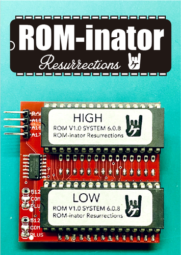

Another option would be getting a ROM-inator Resurrections, which makes the Plus compatible with bigger standard EEPROMs:
