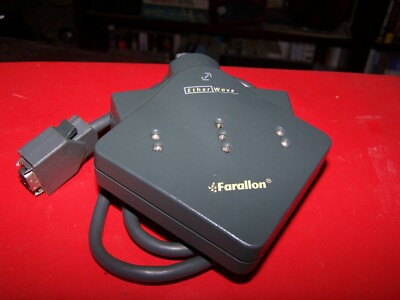

Posted by: mikes-macs on 2023-03-10 17:55:42 I use one of these but I’m sure you can find ones less costly.
Has AAUI connevctor on one end and two 10BaseT ports to connect to network.
www.ebay.com
Posted by: craig1410 on 2023-03-10 19:03:32
www.ebay.com
Thanks, I’ve ordered a Netgear EN104 hub from ebay which has 4 RJ45 ports in the front and a BNC coax plug in the back. Should be here next week sometime. It was GBP £69.95. I’ll need to get some BNC T connectors and some terminators I guess. The joys of 1980/90s ethernet! 😀 |
