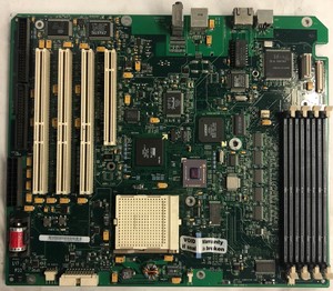

The three slots are 64-bit 5V. The shorter one is indeed a 3.3V 32-bit slot
Both of my Rage128 cards are keyed to plug into either 3.3V or 5V slot:
And A lot of Rage II cards I'm seeing, and even going back to Mach64 ATi cards are keyed 5.5V only, so I'm assuming yours is a Rage128 😉
You can plug 32-bit cards into 64-bit slots and it should work, unless yours is only keyed only for 3.3V. But if that's the case, you wouldn't be able to physically seat it in the 64-bit slot anyway.

Pretty sure mine is a Rage128.  I kind of recall seeing 128 on the board.  I don't think it fits in the three larger slots.  At least it didn't seem to line up right with them when I had it out.  I'll try again when I open it up again.

Yeah, it should seat correctly:
Stolen from: https://www.ni.com/en-us/support/documentation/supplemental/18/pci-keying-and-voltage-compatibility.html
With the 5V key seating before the "extra" pins behind it (or on the right in this image above)
