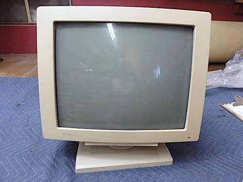

Posted by: Phipli on 2022-06-22 16:55:52 BTW :
Find many great new & used options and get the best deals for Vintage Apple Computer Mobius 2 Page Display Monitor Nice Condition at the best online prices at eBay! Free delivery for many products.
www.ebay.co.uk
