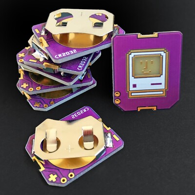

Posted by: falen5 on 2024-09-30 05:16:05 recently saw one of these fitted to an se/30 i was working on
MacBatt CR2032 PRAM Lithium battery replacement for Apple Macintosh computers | Computers/Tablets & Networking, Computer Components & Parts, Computer Cases & Accessories | eBay!
www.ebay.ie
id imagine you would have to slice off some of the sides to get it to fit into the battery slot of a 128 to a Plus
but at least you wouldnt have to ever worry about acid leaks again |

but at least you wouldnt have to ever worry about acid leaks again I use these wherever I can (not in a 128K/512K/Plus!) They are excellent. They fit perfectly into the 1/2 AA battery holder. |
Posted by: finkmac on 2024-09-30 06:00:03 i just desolder the 1/2 AA holder and solder in a cr2032 holder. works out cheaper |
Posted by: Insanely Digital on 2024-09-30 06:40:28
i just desolder the 1/2 AA holder and solder in a cr2032 holder. works out cheaper Yep, that'll work. I like to preserve the original look of the boards. That's just me. |

Posted by: Insanely Digital on 2024-10-09 05:09:49 Here's a picture. |
