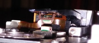

After a diskette completely jammed in the floppy drive, I was forced to pry it out with pliers. Unfortunately, such a procedure is far from delicate, and the top drive head was damaged and put out of place. (Actually, I managed to damage the head before even attempting the pliers; they were simply a last resort..) Attached are photos of its current state.
Shoulda-woulda-coulda, the deed is done; is it repairable, or is it time for a replacement?

Cant repair, just put a new head assembly on. It is really easy. One screw, one ribbon, done.

Posted by: techknight on 2019-04-22 16:08:02
Yea, even if you tried to repair this, youve lost all possiblity of obtaining cylinder/track alignment between sides.
