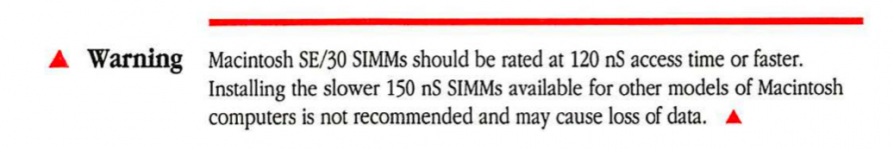

ok I found the answer. It is in the "Macintosh_SE_30_Owners_Guide_1988". I guess I should RTFM.
I wanted to attach the owner's guide but I don't have enough space so I am attaching page 83 of the guide (page 101 of the PDF).
Macintosh SE/30 SIMMs should be rated at 120 nS access time or faster. Installing the slower 150 nS SIMMs available for other models of Macintosh computers is not recommended and may cause loss of data.

Posted by: Alex on 2018-08-08 15:38:10
Judging from the "warning" in the screenshot I posted, I think it would be fair to assume that the SE user guide would mention a similar warning on 150 nS or faster RAM.
