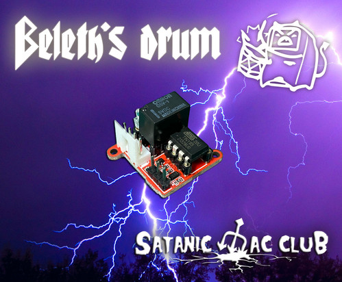

Could I reopen this thread with a perhaps silly, but perhaps practical question:
Can this card be used with Beleth's Drum (HD audio simulator)?
I like using my Mac, because of the hard drive's whirr. 🤣
Posted by: zigzagjoe on 2025-12-16 06:21:15
I put an activity header on the card for an external LED so I would expect it'd work.
