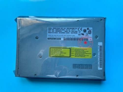

Posted by: zefrenchtoon on 2023-03-30 08:14:43 Hello!
Does anyone buy one of these ?
Find many great new & used options and get the best deals for FUJITSU MCM3130AP IDE 1.3GB MO Magnetic Optical Drive at the best online prices at eBay! Free shipping for many products!
www.ebay.com
It seems very cheap for a NOS drive, no ? 😵 🤔
It would be great to be able to put one in my 6100 ... 🤩 |

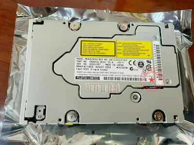

Posted by: olePigeon on 2023-03-30 08:28:58 @zefrenchtoon That one is IDE, not SCSI.
Same seller has 2.3GB SCSi version for $120, which is the highest capacity drive.
Product Model: MCR3230SS. Manufacturer: Fujitsu. We keep our promises that we will provide you with the best solution within 24 hours.
www.ebay.com
And here's the SCSI version of the drive you were just looking at for $90, just $10 more:
