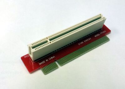

Posted by: Trash80toHP_Mini on 2024-09-25 21:15:57
Excellent! I actually have a three PCI card riser wired up for Slot A, B and C usage, but as of right now I cannot test it, because my PCI extension module is not long enough for the riser to properly clear the case. I just ordered up one of these, it might help in your use case:
It'll sit my three slot PC riser with cards vertical, the three slot riser easily clearing the fan on the CPU and the Battery.
32 Bit Direct Plug In 1U Riser Card. Right Angle (Inward facing). Browse our featured categories. Browse All categories. Although quite a number of manufacturer have adopted the 100-240v (autovolt) power, still a large number of electronics devices may still be mainly 110v.
