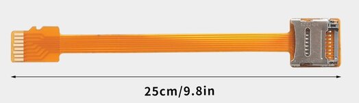

Posted by: Trash80toHP_Mini on 2025-03-28 09:25:51
Mentioned CF->SD adapter upthread. @zigzagjoe said there were requirements that need to be met for adapter to work.
Micro SD slot on the backplane?
edit: throw socketed CF adapter onto a reloaded logic board with new build PDS card stack into a clear case? 😁
All brand new (aside from proprietary chips) build boards without overloading the PDS electrically? Bonus points for all BLACK PCBs!

Posted by: jmacz on 2025-03-28 10:40:17
I've never really had good luck with these type of extenders. I bought a bunch of different ones and each one had reliability issues with the part that mimics the actual card. For some reason they aren't meeting specs and so I found random IO failures that go away when putting pressure on that end of the cable, etc. Or part of it might be some degradation in the signal over the length of the cable. Or shielding issues and depends on how you route the cable. But never had luck.
What's interesting though is the one you pictured above, I just recently picked up that exact one. It has that weird clamping mechanism for the actual micro SD card. I thought I'd give it another try for my PowerBook Duo. That one seems to be holding up ok. But again, could be because it's shorter and/or I'm routing it through an open area with no interference. 🤷‍♂️
