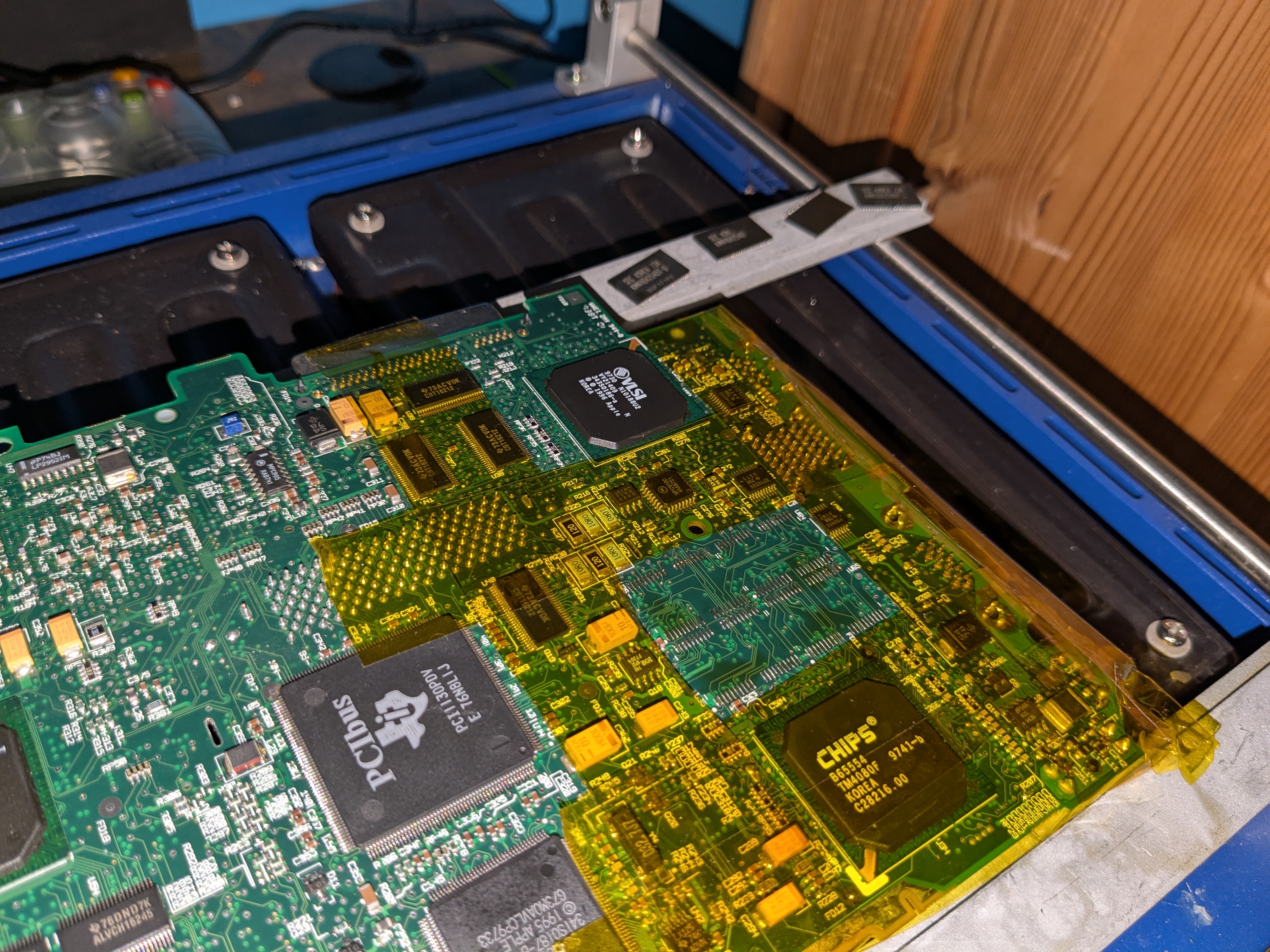

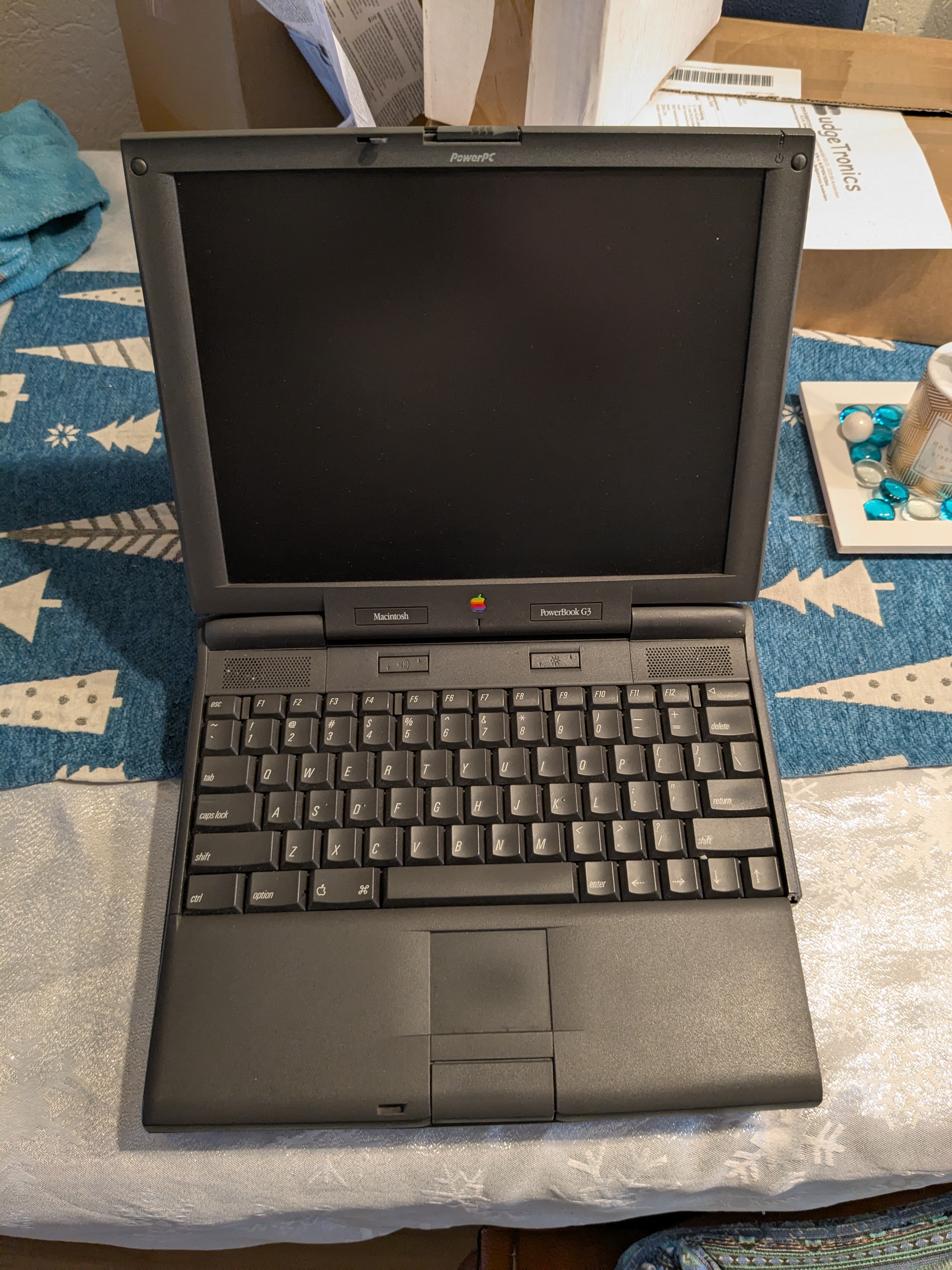

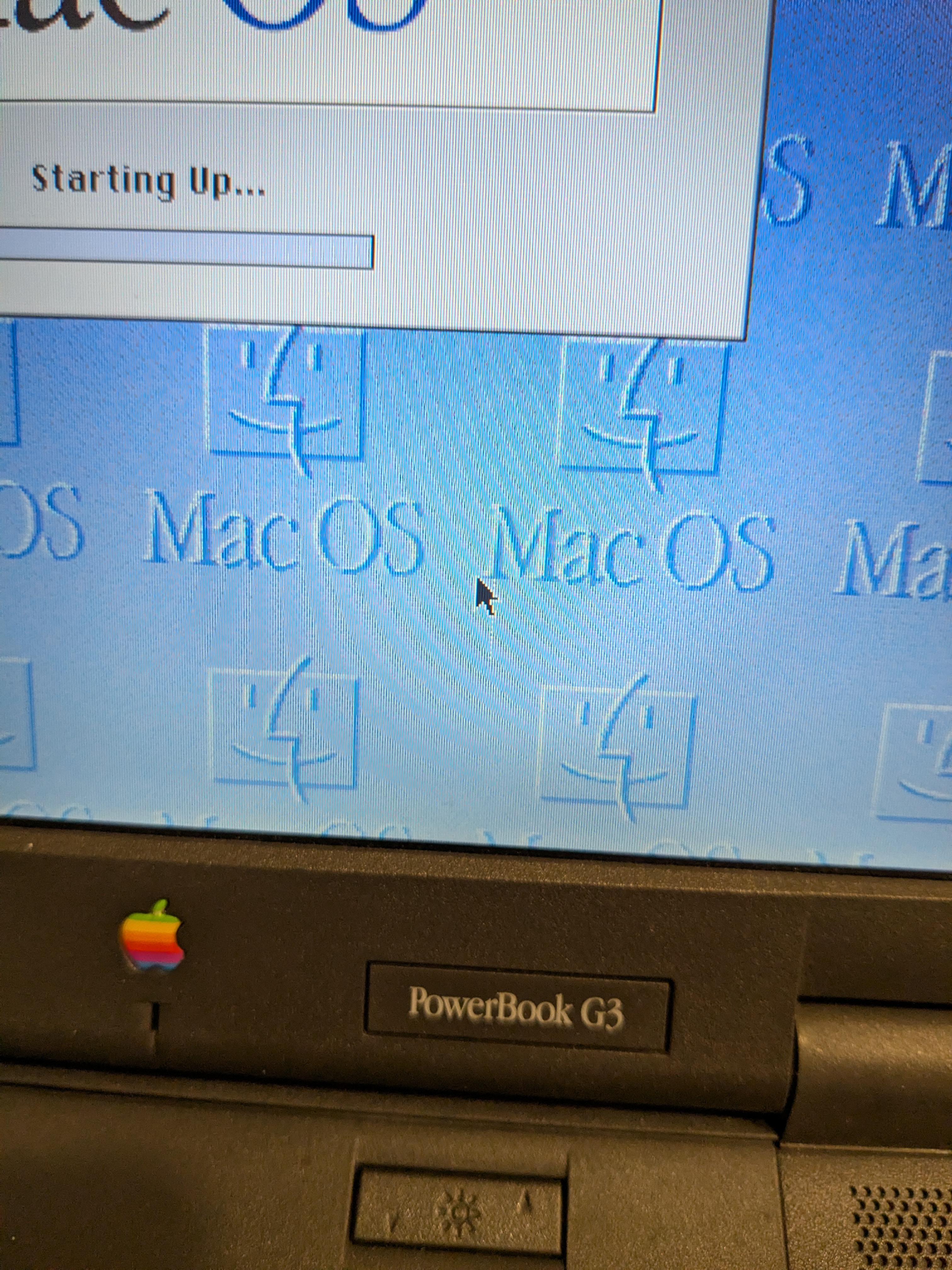

Back in 2025, I bought a sold-as-broken PowerBook G3 Kanga locally for pretty cheap.
After pulling the leaky, dead PRAM battery, it worked, but showed some serious graphical corruptions on the cursor (faint line of pixels on the right), and highlighted text selections.

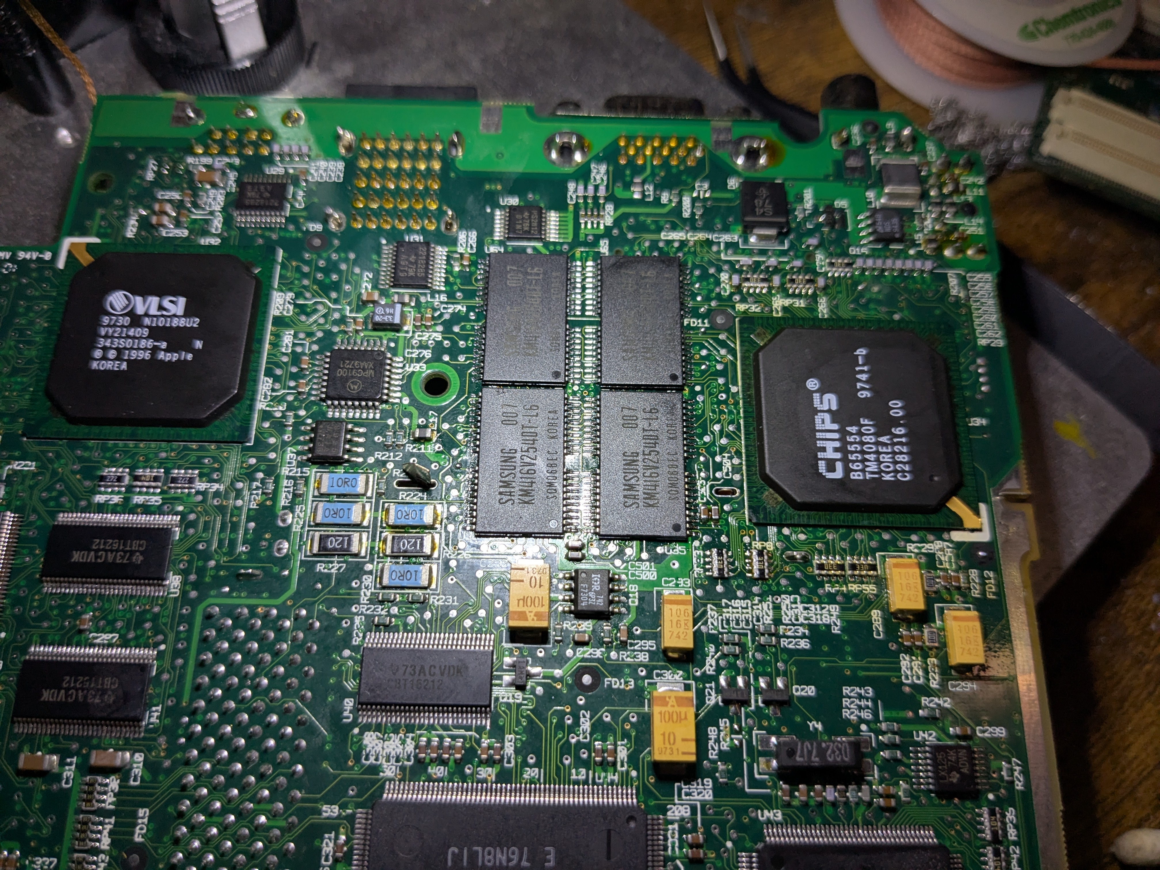

I had ordered the replacement VRAM chips for this a while back, as I suspected one or more of those having gone bad, as no battery leakage got to the logic board.

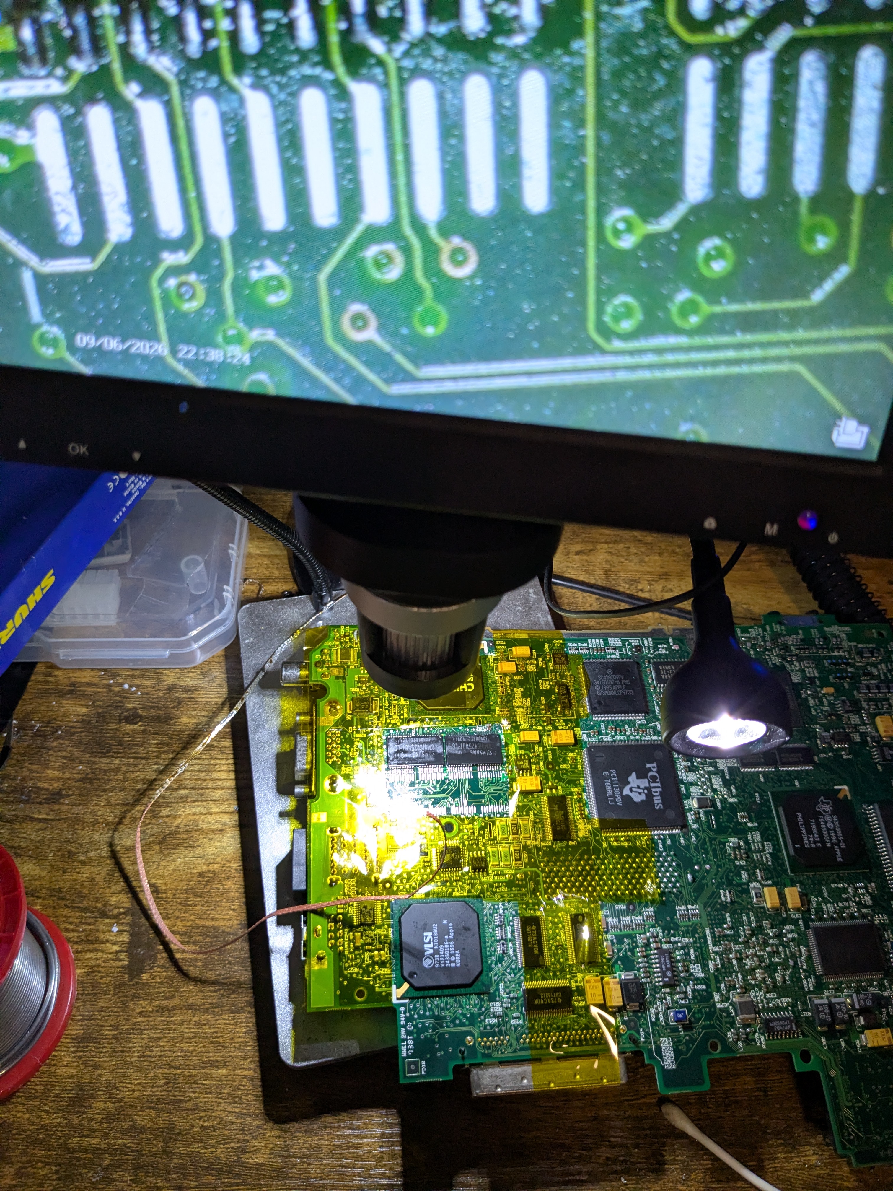

Tonight, I finally took the opportunity to tear down the PowerBook, get the logic board out and do a VRAM chip swap.

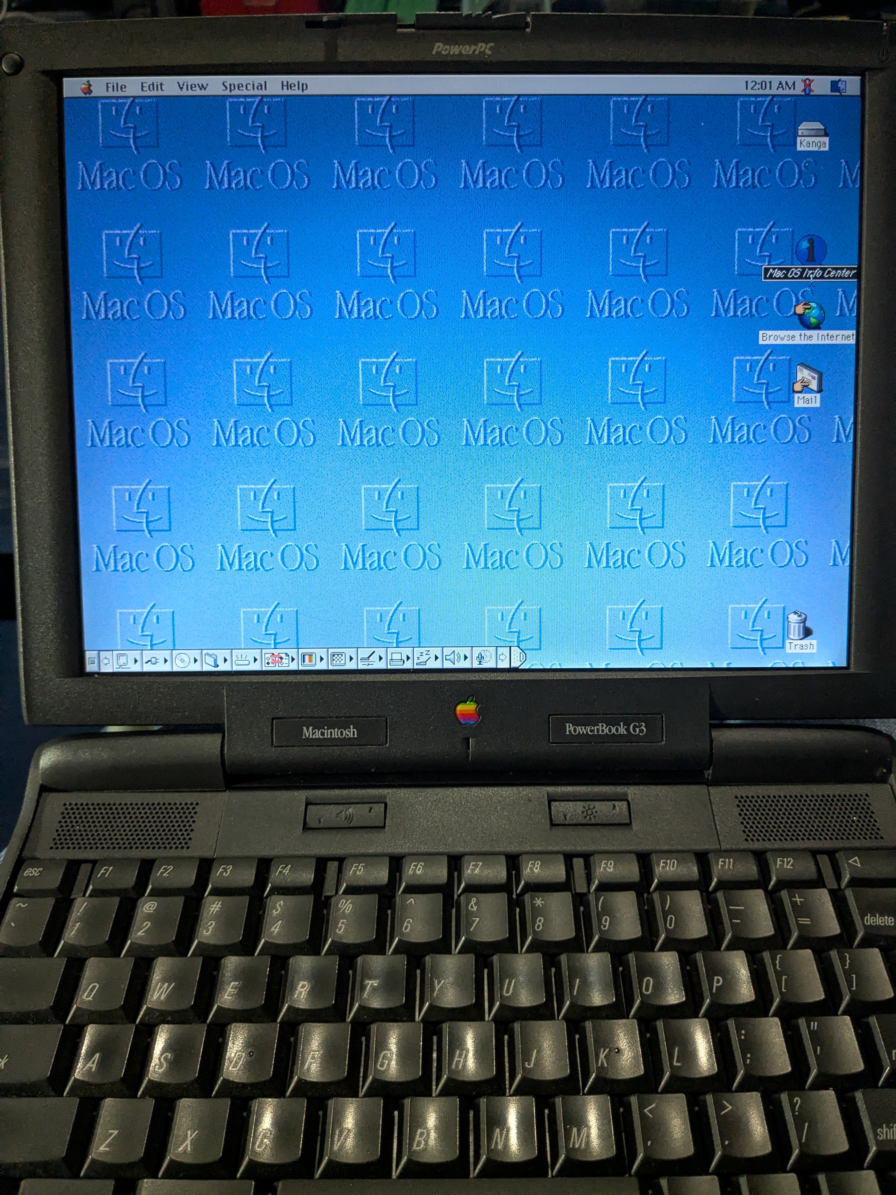

The great news, not only does the PowerBook still work afterwards, the graphics corruptions are gone!

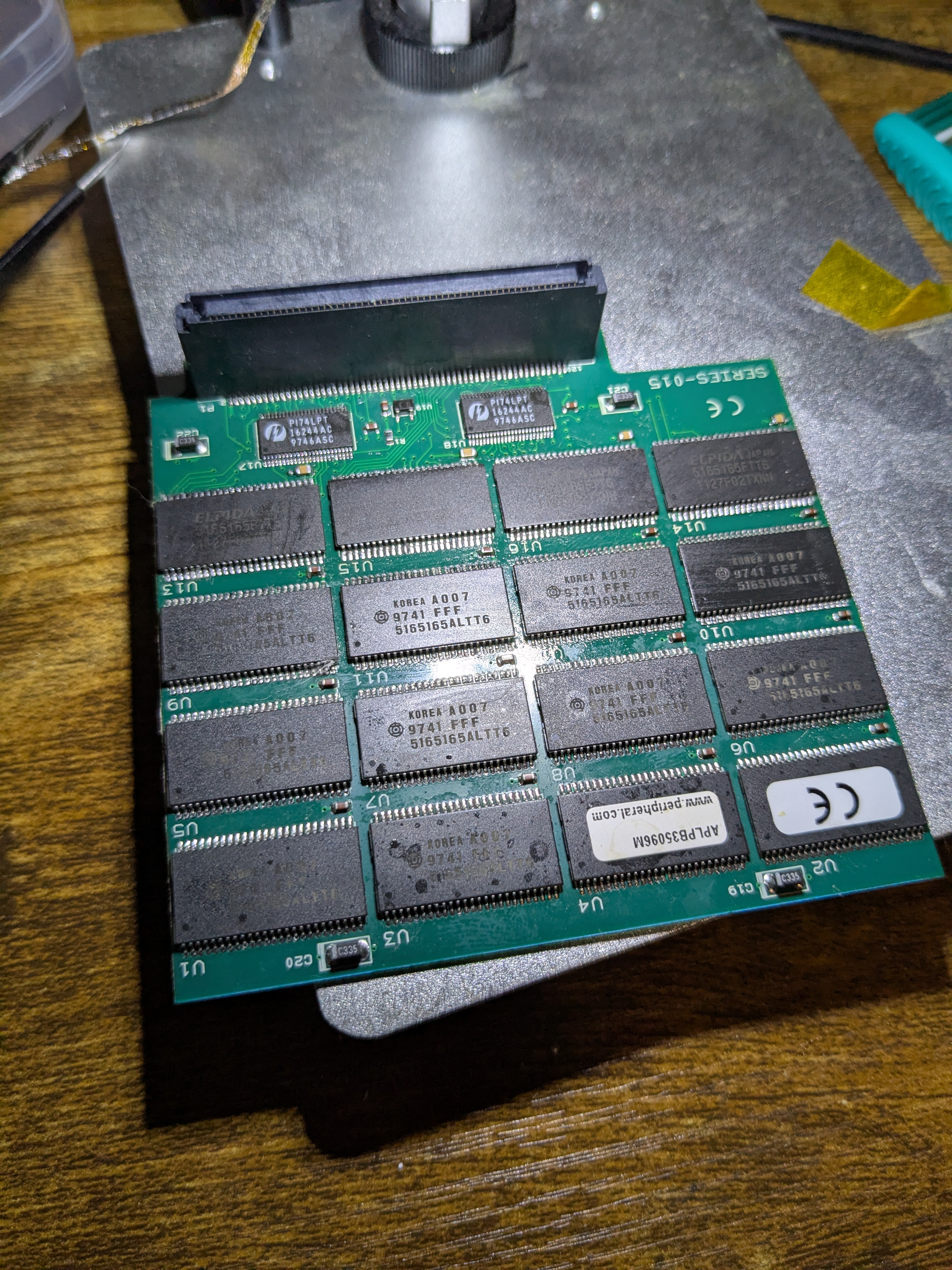

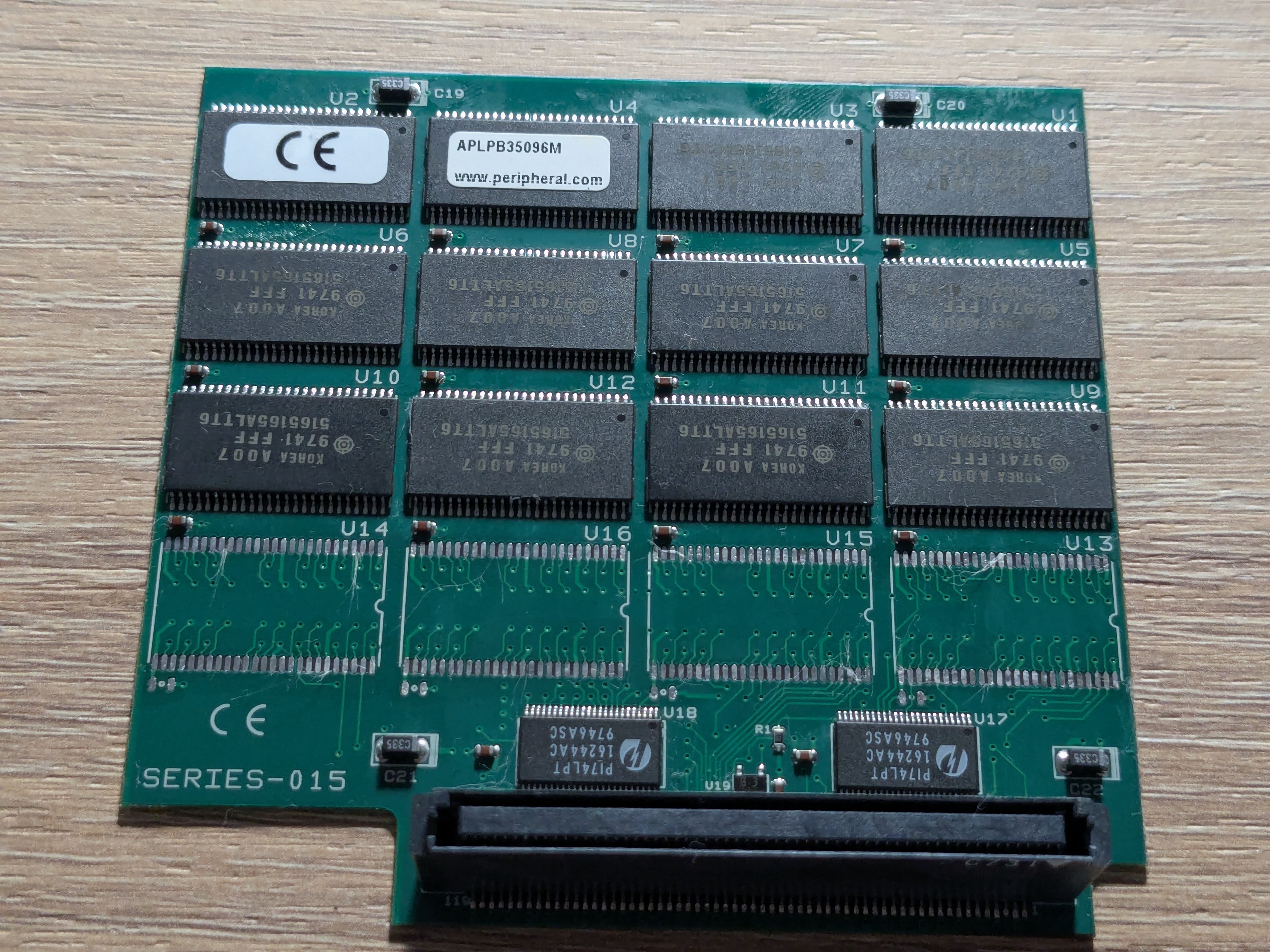

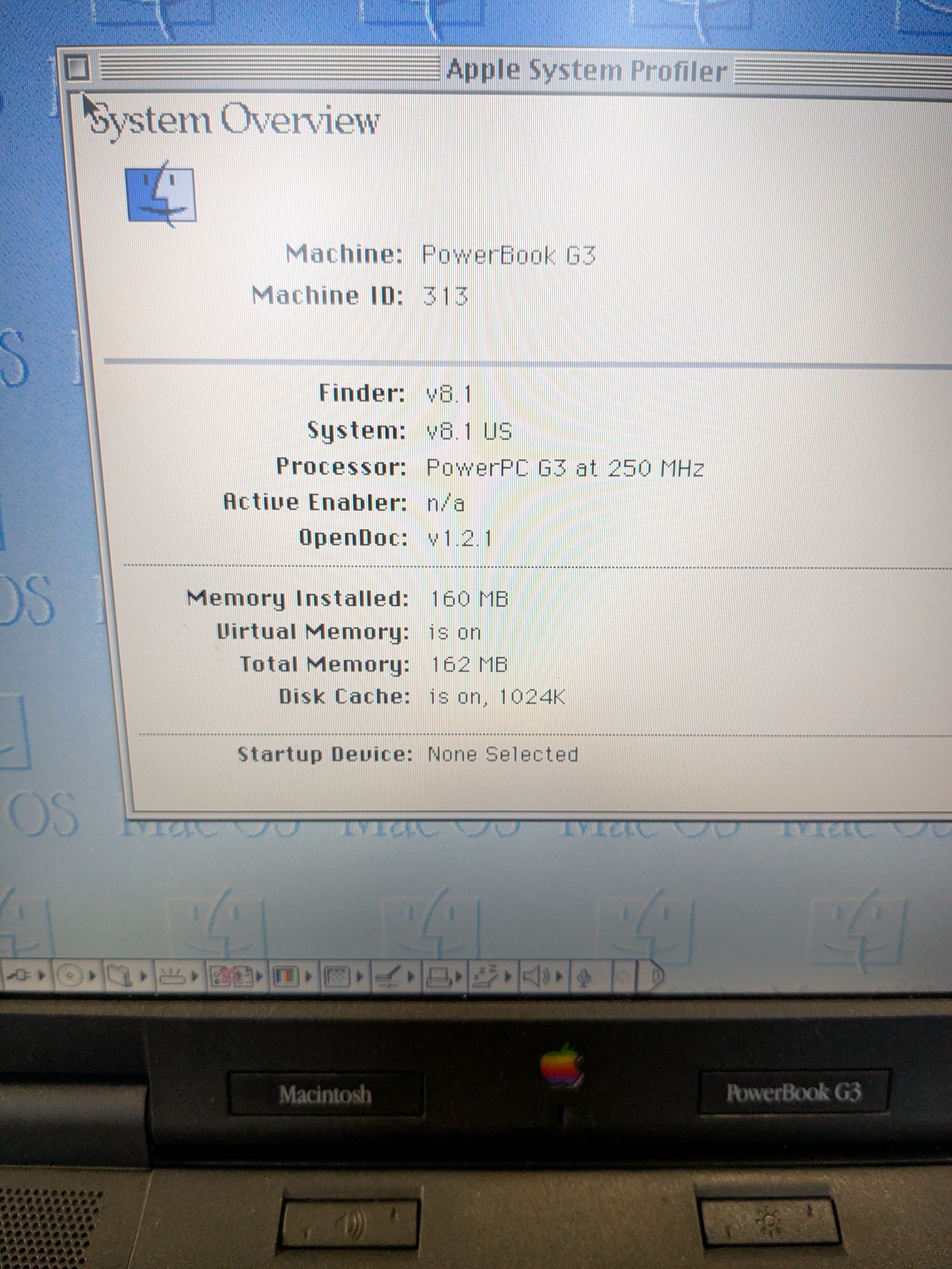

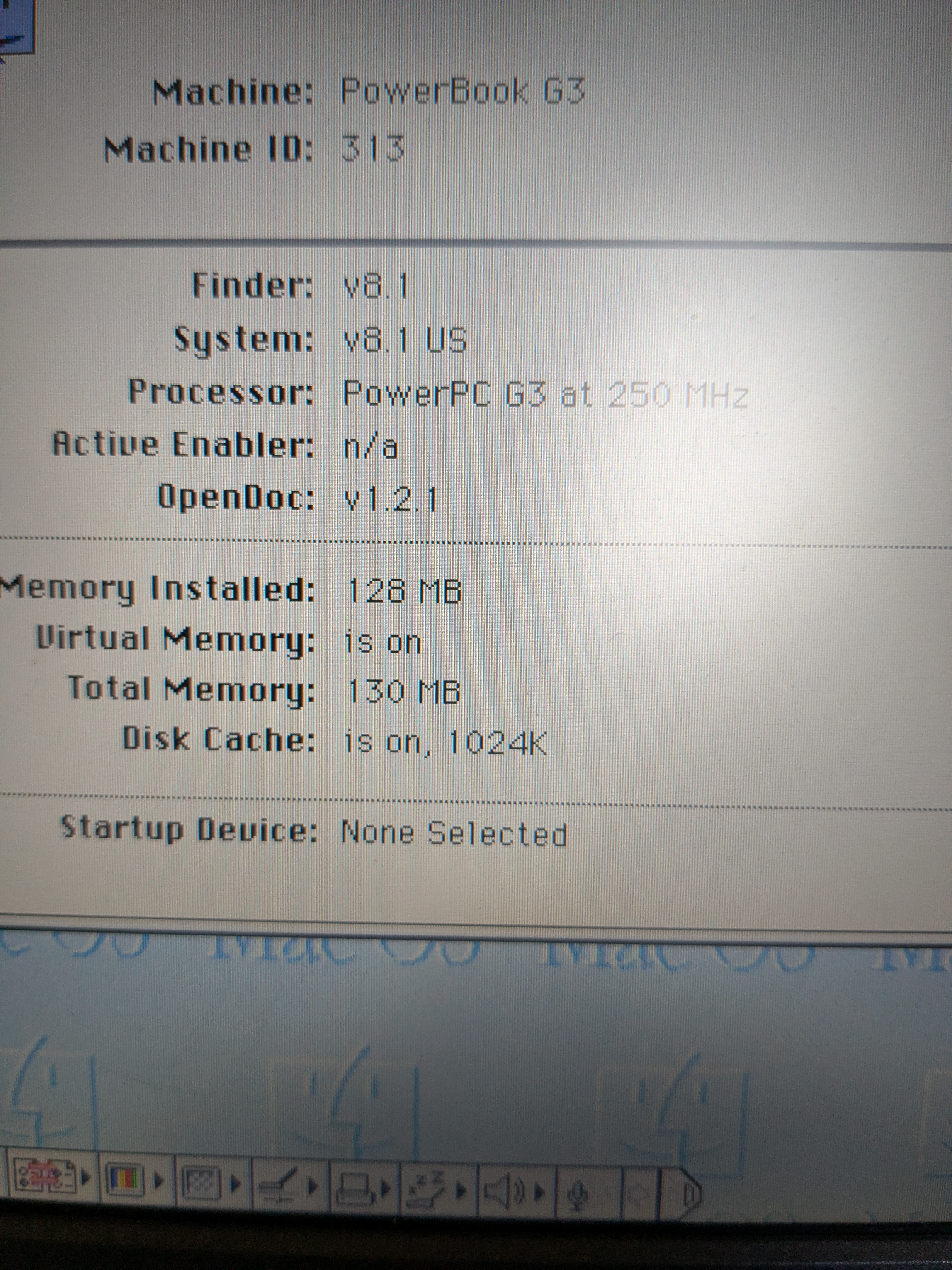

And as an add-on, I also went ahead and took the 96MB card I had for the Kanga up to 128MB to max out the system at 160MB.
Not the greatest solder work (the connector makes it awkward), and it required a re-flux and reflow with hot air, but looks like that did the trick:
This mod didn't require anything other than adding the RAM chips and bypass capacitors, no resistor straps or anything like that on here.
Posted by: croissantking on 2026-06-10 13:39:13
Good work. I understand 160MB is the absolute maximum the logic board’s PSX chip can address with the available RAS lines.
