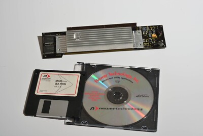

Posted by: dust bunny on 2024-04-15 03:42:16 Stumbled on these while surfing...
Very specific knowledge of its era is required. In other words, I’m not your tech support (but am helpful!). Drivers are included on floppy and CD.
www.ebay.co.uk

Posted by: dust bunny on 2024-04-17 14:15:35 I’ve spent this evening disabling system 9, and installing 7.5.(1?) it all appeared to work perfectly, so I installed the Newer Technology driver.
It seemed like a good idea at the time, but when it suggested I should Restart, it then couldn’t start. It got stuck immediately after the Newer Technology logo.
Several re-restarts later and it worked. I don’t remember how to get 7.5 to tell me what CPU and speed it’s running, but it feels significantly faster than 60mhz. |
