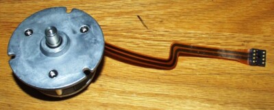

Apple Lisa Widget Drive Motor. Labeled as Widget Drive Motor. Appears Unused Condition.
www.ebay.com
That is the component that I damaged by breaking two pins off of the ribbon cable. Is there a non-destructive way of replacing that part of the Widget? I removed the three screws from the little metallic cover disc on mine, but all that did was enable the cover to spin in place (opposite the brake). It did not allow me to remove it. | Posted by: stepleton on 2023-02-04 15:12:02 I doubt it. While I don't know for sure, there's likely no way to remove the arm from the shaft of that motor without disassembling the drive down to its mechanical elements. If you had the equipment to replace this motor completely (including the glove box or clean room), you would very likely already have the equipment to rebuild the hardware you have now.
Keep in mind that replacing parts like this isn't just about replacing old with new, it's also about placement to very fine tolerances and likely also some sort of recalibration process. | Posted by: ried on 2023-02-04 18:37:28
"...it's also about placement to very fine tolerances and likely also some sort of recalibration process." Knew it. 😒 | | < 4 > |
