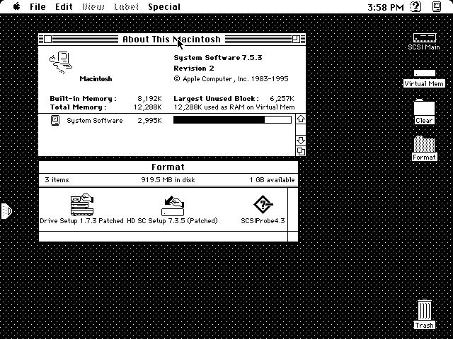

Posted by: Phipli on 2022-06-12 07:12:53
Ok should be here Monday, in the meantime do you happen to have a remade image of Mac OS 8 that I can just copy and paste into the SD card? You can do that if you restore an image to the whole SD card (not just put an image file on one - I was experimenting doing that but forget how far I got and how usable it is! Link here anyhow, not set up to test sorry.
IDE to SD Quickstart The following guide is designed to get up and running quickly with a IDE to SD adapter when you don’t have any installed OS on your antique IDE (aka ATA) Macintosh such a…
stuffandnonsense.elephantandchicken.co.uk
Looking forward to see the outcomes of the Alpha 7.7 and what speed it is running at. System Profiler will tell you what speed it is running at (see attached for the older and newer styles). Might also be interesting to dump the ROM. |

Looking forward to see the outcomes of the Alpha 7.7 and what speed it is running at. System Profiler will tell you what speed it is running at (see attached for the older and newer styles). Might also be interesting to dump the ROM. Thank you so much I’m gonna try this out tommorow when it arrives with Mac OS 8 or 7.5, not sure which yet. As for the ROMS I believe they are soldered to the board but I’ll double check. |
