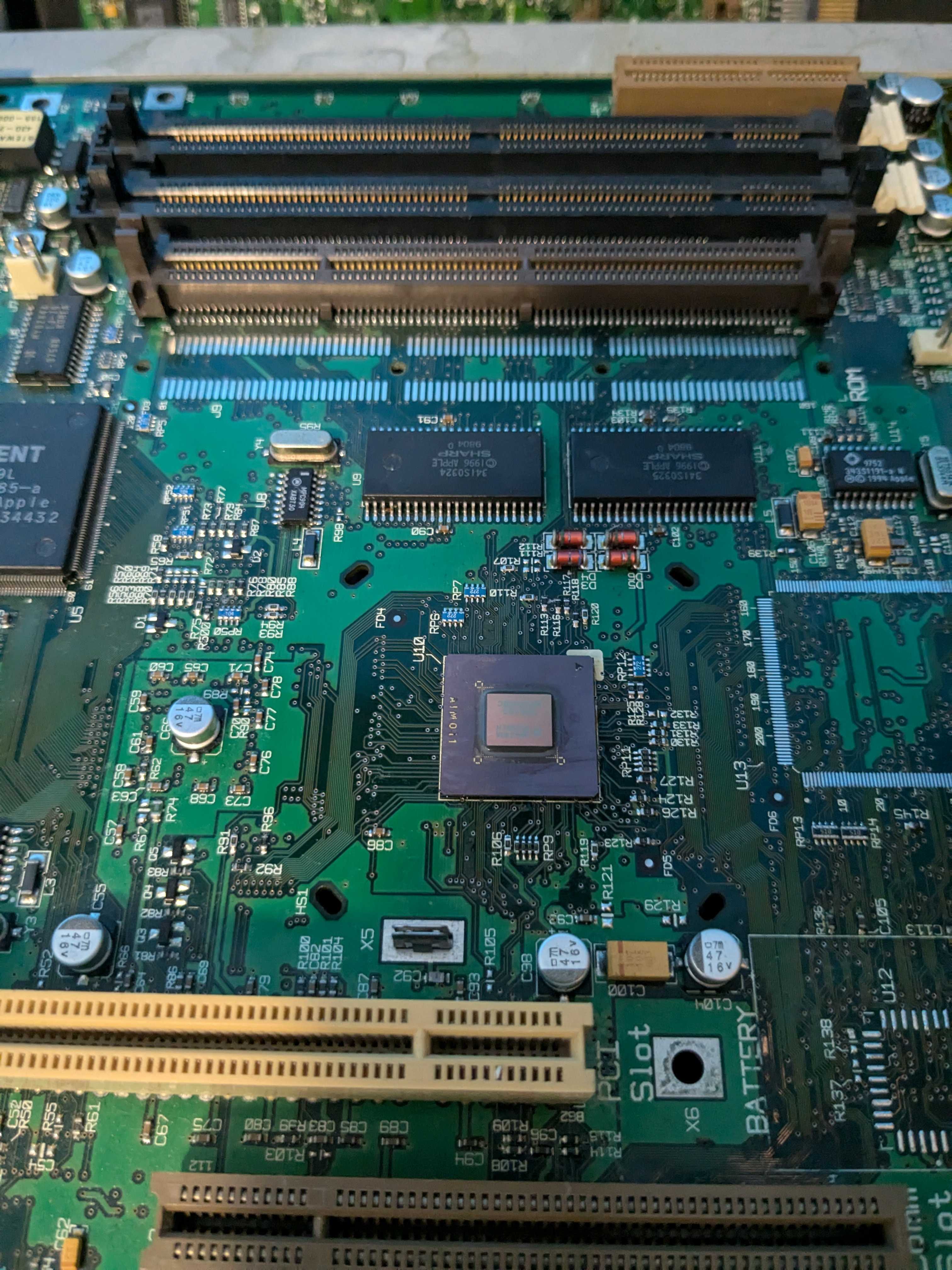

Has anyone put a 740 onto one of these boards?
Coincidentally, I just fitted a Performa 6500 board with a Motorola 740ARX266, still need to tinker with the PLL, but yes, it does work π

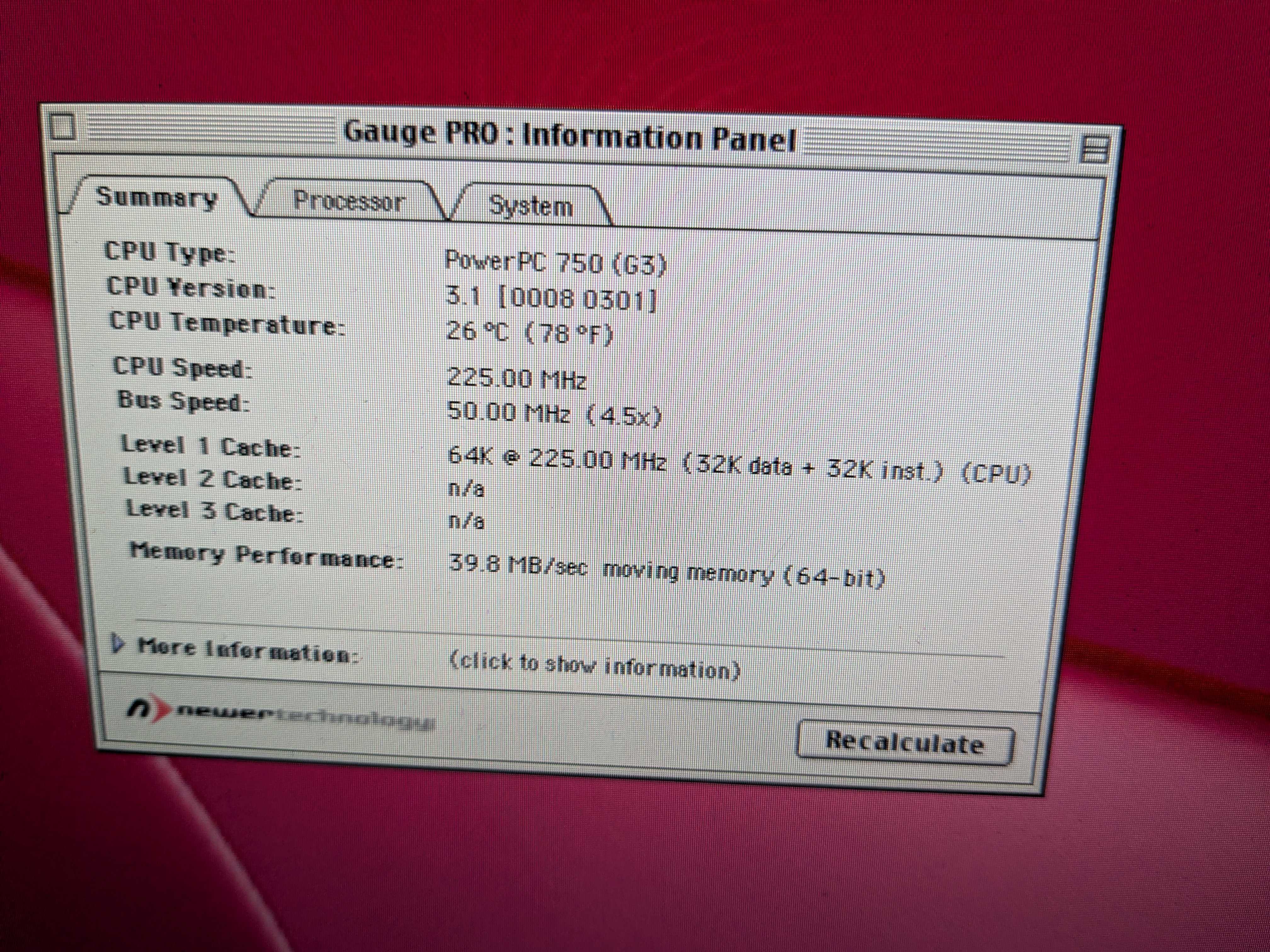

So, ooof. A G3 without a cache takes a mighty oomf to its performance. I know the L2-less Wallstreets were pretty bad | Posted by: pizzigri on 2024-08-23 15:26:30 @Powerbase, yeah! I had even replied to that, really really fascinating. I wish I had a larger preheater than the 853A, I'd love to try this....
it seems from re reading that thread that it is indeed possible to use the L2 cache that the 603e came with on the board, and that it does some good... | Posted by: LightBulbFun on 2024-08-24 17:32:27
The CPU clock speed is not reported correctly and I would guess that another PVR check is used there, which also reads HID1 to calculate the CPU speed and populate the device tree Just been thinking about this, which PLL are you using/setting to achive 800Mhz? since I know the 750FX and 750GX are a bit sepcial in that they have 2 PLL's PLL0 and PLL1, so I wonder almost if the Sawtooth BootROM is reading from the wrong PLL range?

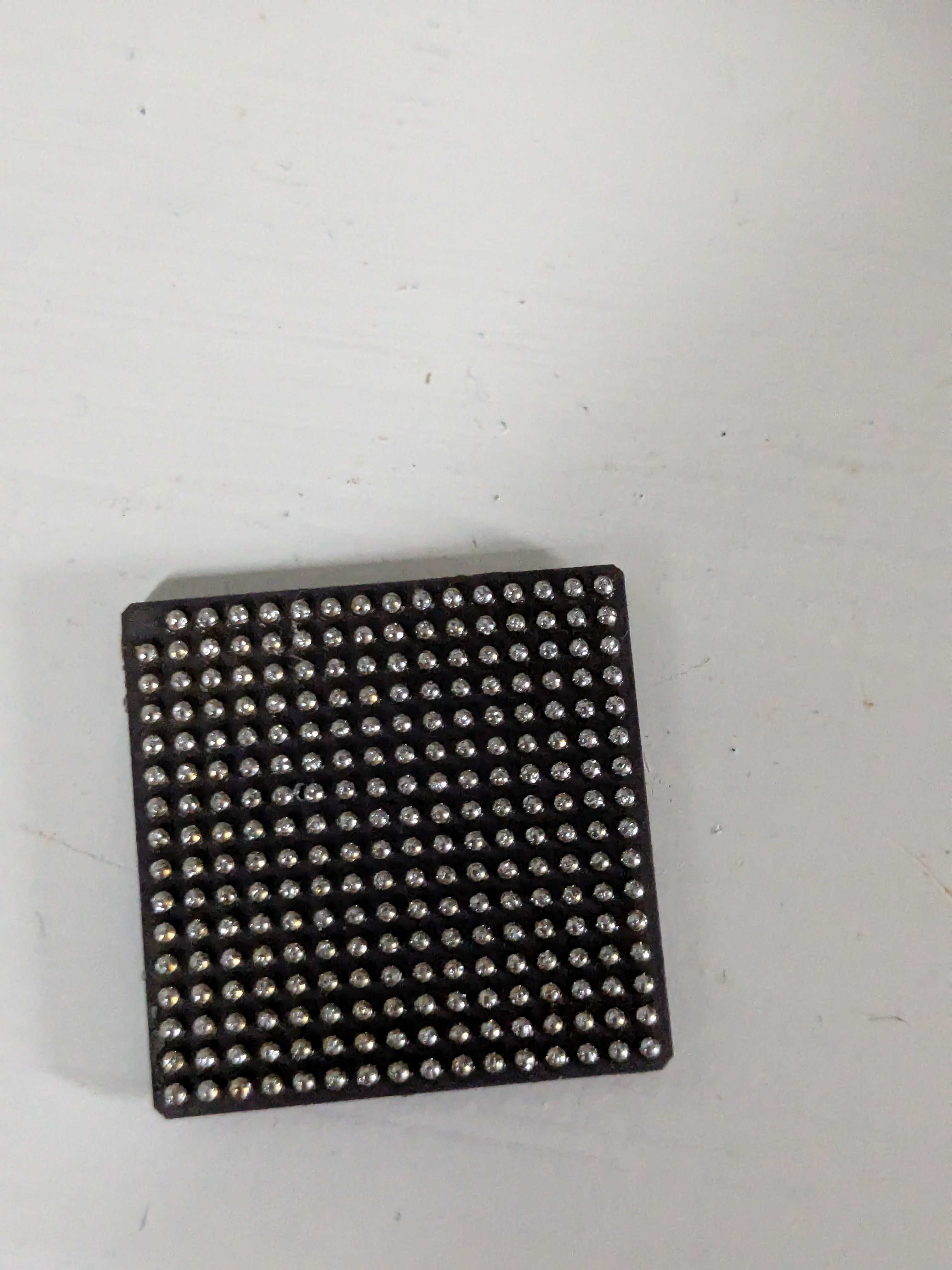

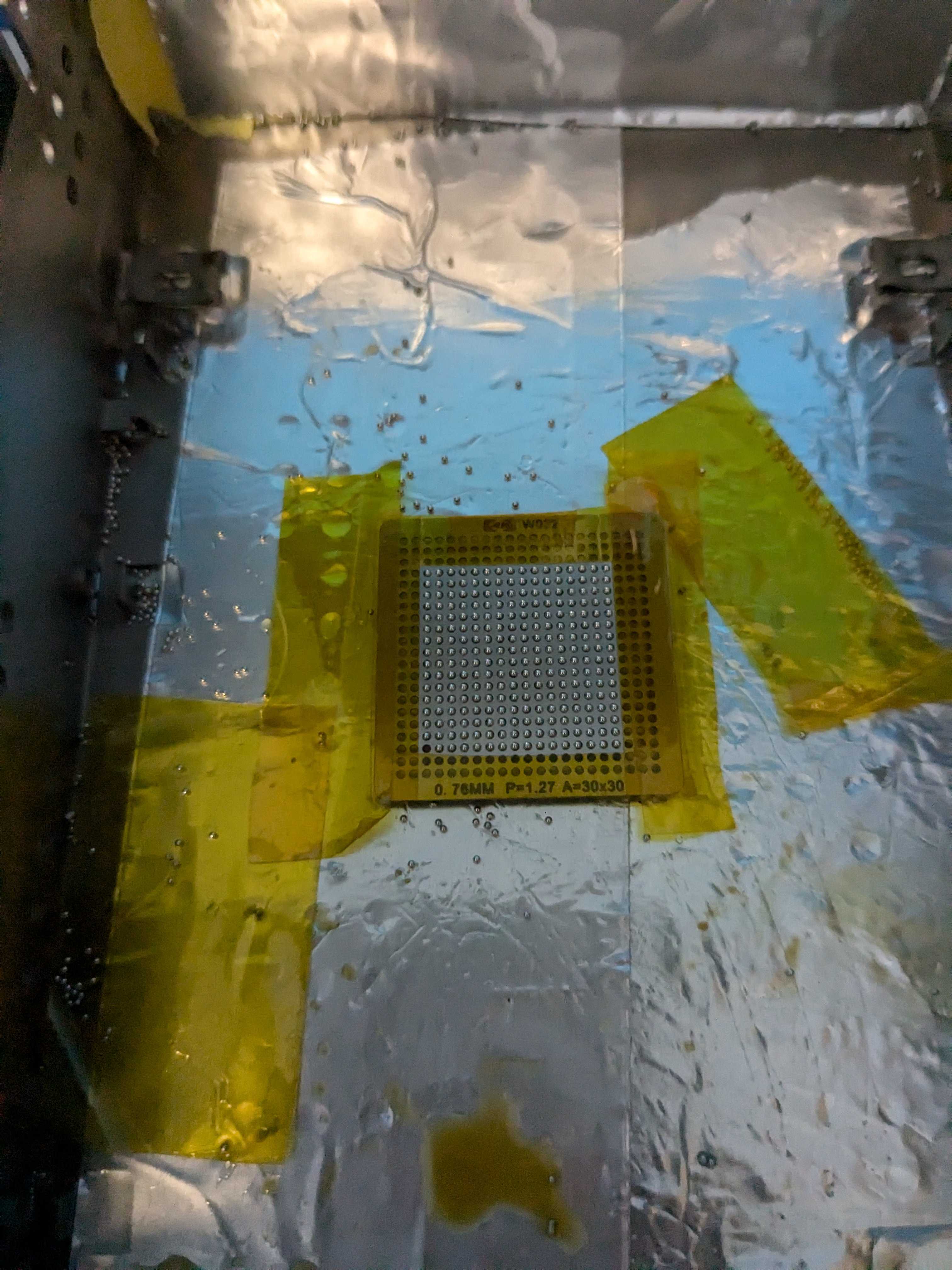

Thanks for sharing your experience. The OEM chips typically used a 0.89mm Diameter 90% Pb and 10% Sn (by Weight) βHigh Meltβ solder ball held between CBGA substrate and PCB with regular eutectic (63Sn/37Pb) solder. The idea was to have a ball that would not collapse when attached. The resulting column of metal would allow some flex to accommodate the difference in thermal expansion between the ceramic and PCB. This was later addressed by the HCTE substrate, and these chips could be soldered directly to the PCB with relatively thin fills.
So basically, to attach a 90/10 ball to a copper pad, you need to add some solder. Solder paste is the typical solution, but other methods are possible for hand assembly. It is not really feasible to directly attach the βHigh Meltβ solder ball to the pad because extreme temperatures would be required and if the ball collapses then there would likely be other problems too.
Or you can remove the OEM balls and use smaller/shorter 63/37 balls. The long term thermal fatigue performance will be reduced somewhat, but BGA technology has proven to be more reliable than skeptics feared at its debut.
