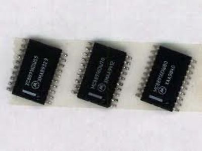

I've had the same experience. I've wondered if it has something to do with the tolerances of the RAM and/or VRAM I'm using. If the machine isn't crashing, just not going faster, then you've hit the limits of the PLL chip. When they run out of overhead they just stop increasing in frequency. |
Posted by: Fizzbinn on 2025-11-12 19:43:20
If the machine isn't crashing, just not going faster, then you've hit the limits of the PLL chip. When they run out of overhead they just stop increasing in frequency. This is the stock MC88920? Replacing with MC88916 like this would be need go hit higher speeds?
◆If there are no special circumstances, your product will not be delayed in arrival.
www.ebay.com
In the Overclock LC475/P475/Q605 without soldering or spicy-o-clock thread I learned that LC475 can be pushed to the limit of the MC88920 by software, but to exceed this limit MC88920 need to be replaced by MC88916. There were some questions about availability and sources that can be discussed here.
68kmla.org
Posted by: zigzagjoe on 2025-11-12 19:58:42
www.ebay.com
Yes, to both counts. |
