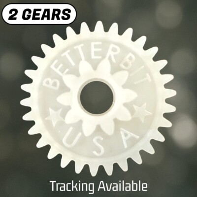

Ordered (2) ebay floppy eject gears, if these aren't great, I'll try the Japan set.

The 4 gears I referred to on Ebay are the correct ones for your drive. Also never has a logo bleach using the paint on peroxide method

Thanks! Ordered (2) of those gears, they were put in the mail today, and they are coming from Sausalito, CA, I'm maybe an hour from there, so I should have those Monday.
