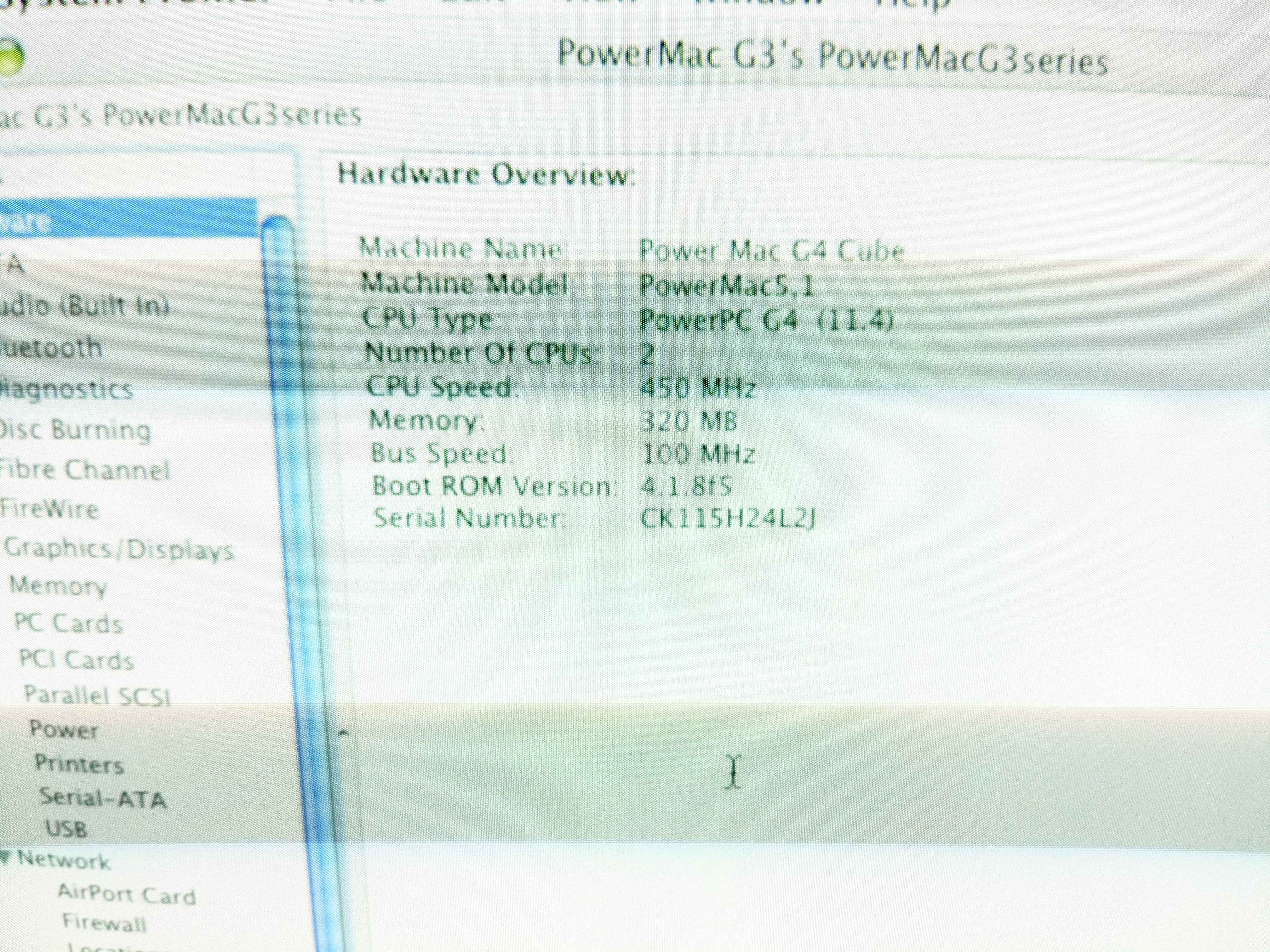

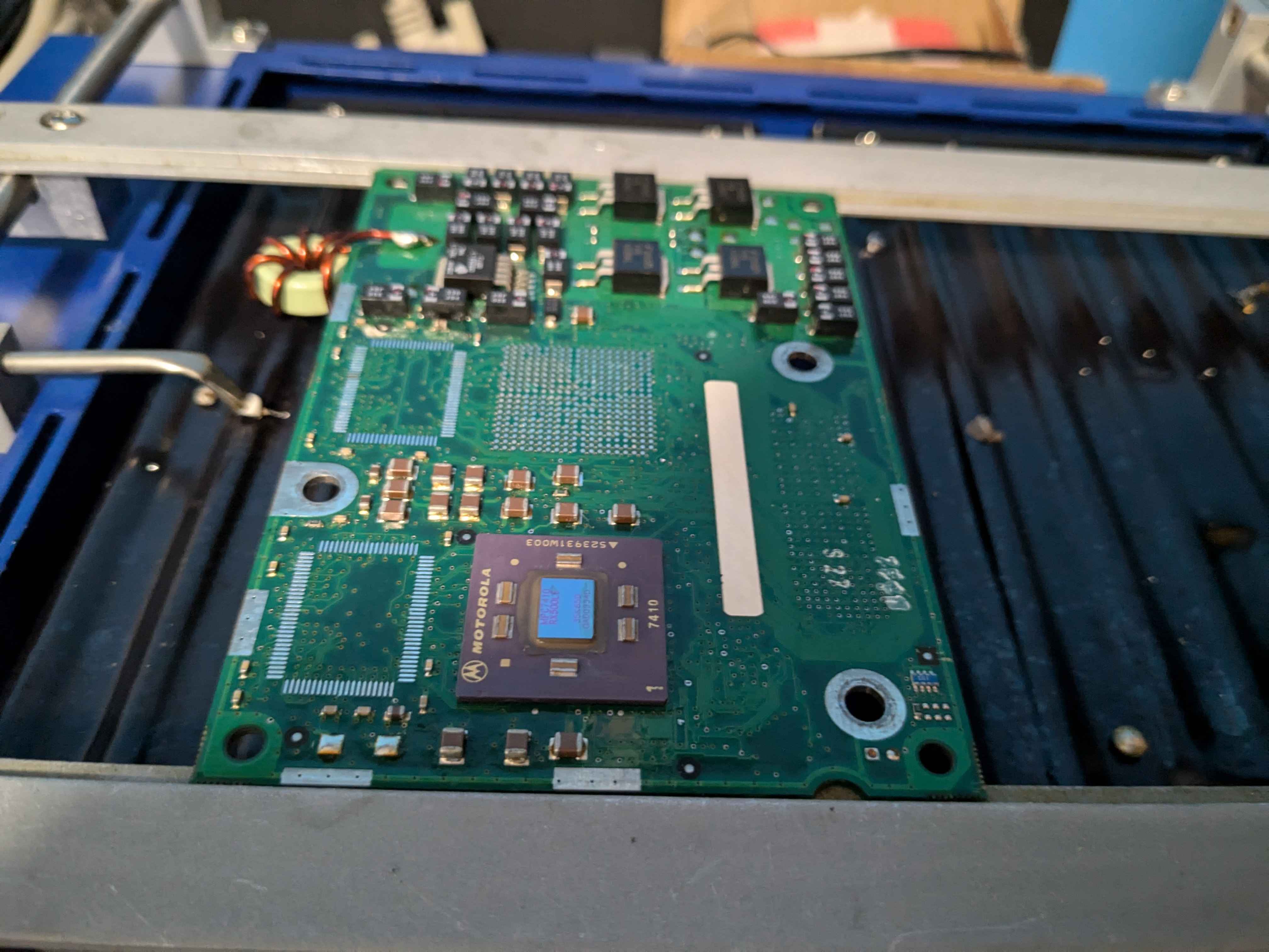

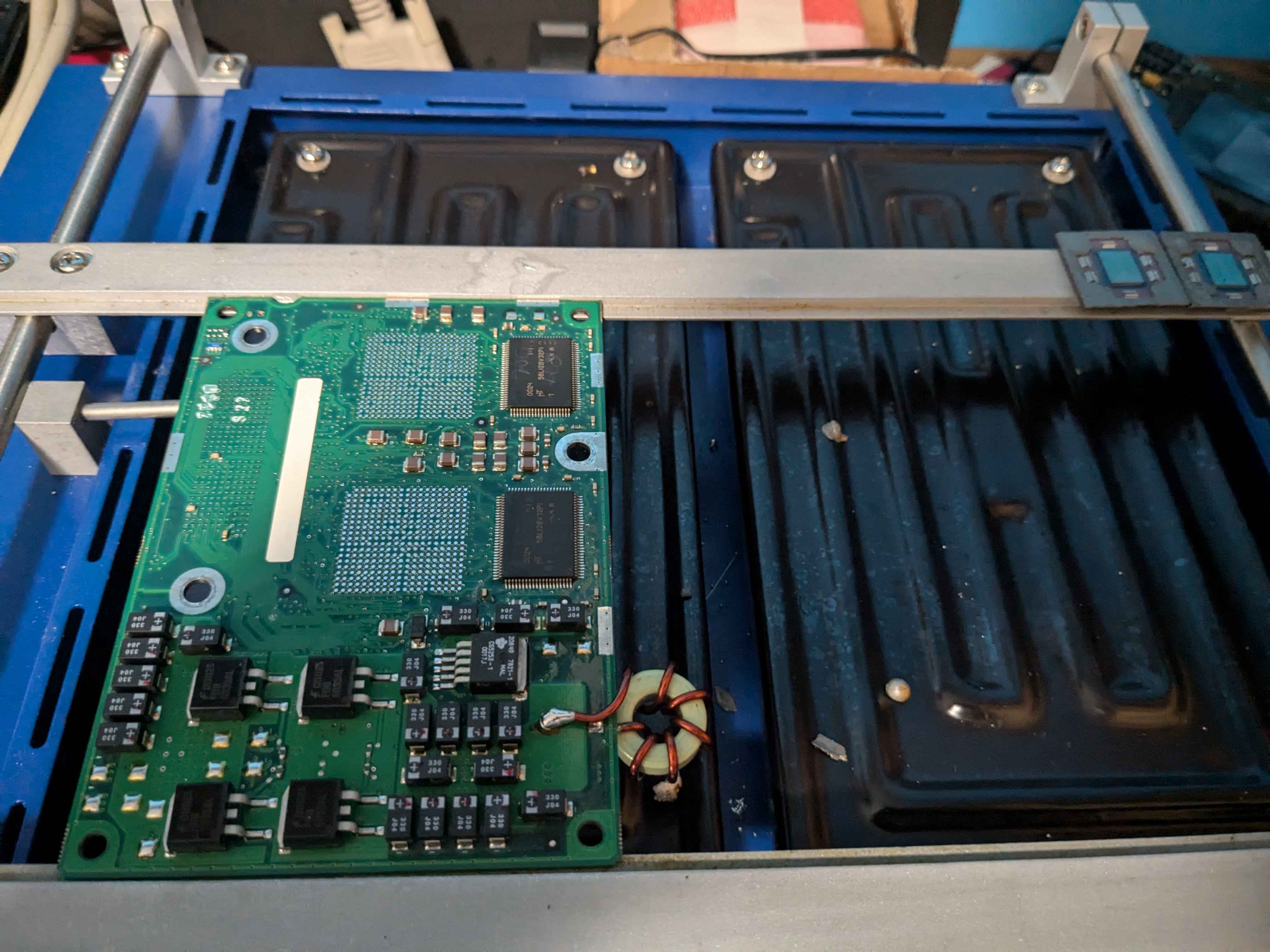

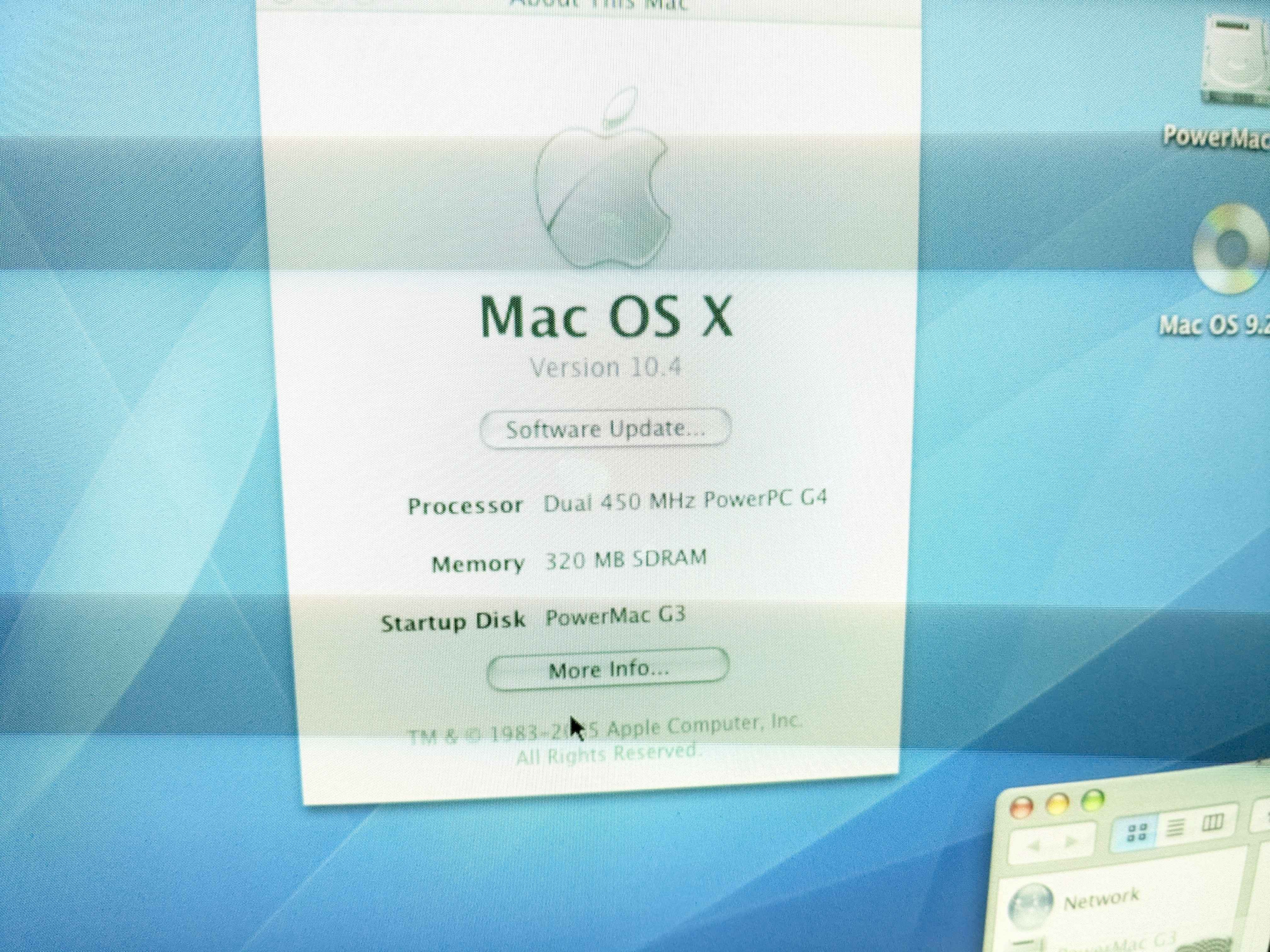

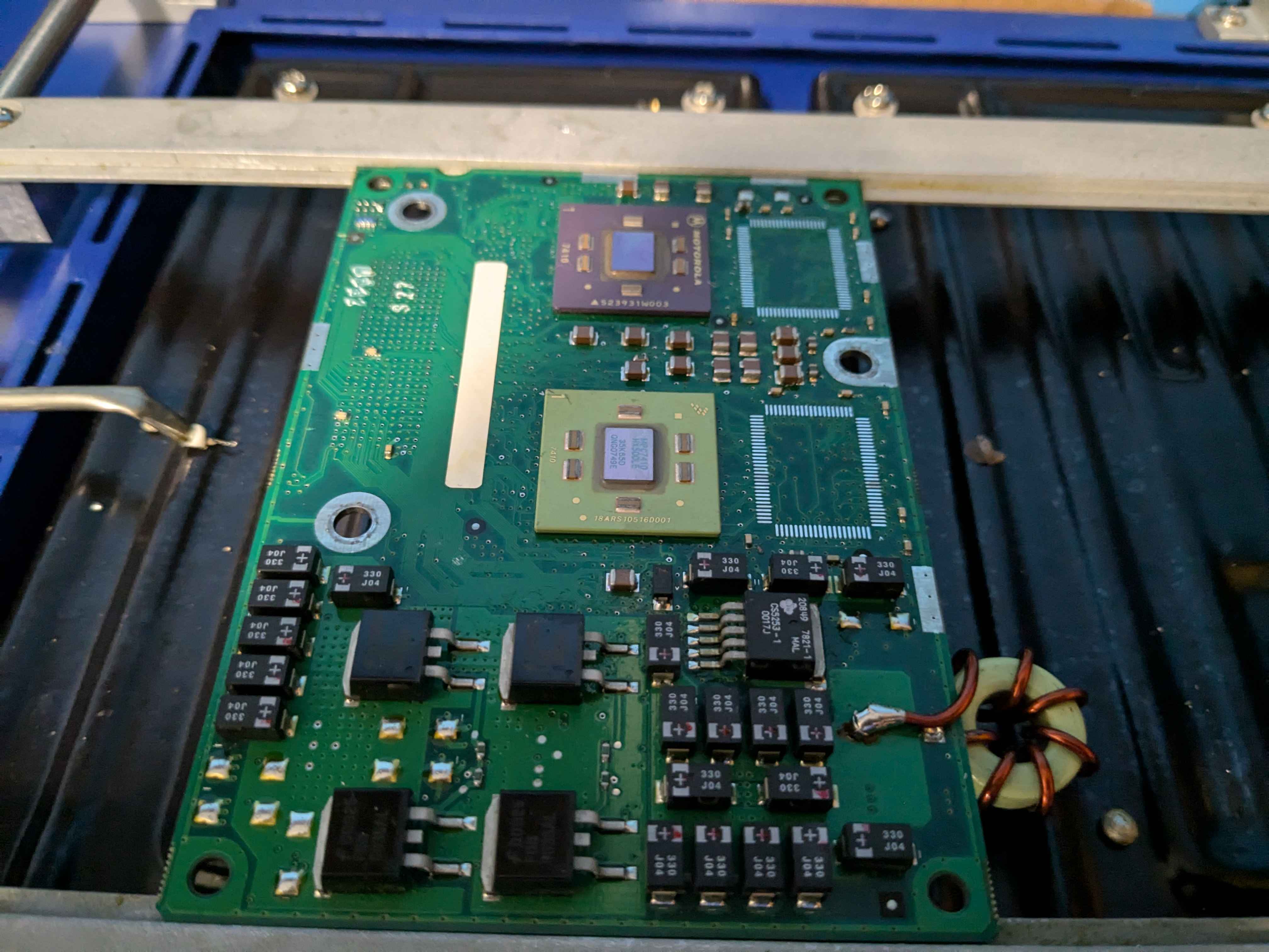

Doing some BGA + QFP work again, this time on a dual 450MHz G4 card destined for my G4 Cube:
Went for a pair of mismatched 500MHz 7410 G4s (same mask though), which are basically just slightly updated 7400s like the 450MHz ones they're replacing.
Main reason for doing this, is because the 7410 is die shrunk and uses less power (and outputs less heat), so I won't have to necessarily get an expensive aftermarket Cube VRM module to stop it from blowing up.
That, and the 7400s are 3.3V tolerant on the I/O lines to the backside cache, where the 7410s aren't.
On certain G3 CPU boards, like the iMac G3 Trayloader CPU cards, the cache can't be adjusted to operate below 3.3V, so using 7410s for a G4 upgrade there will result in a dead cache controller on the 7410 (it will still work, but it can never use L2 cache again).
So I can reuse those 7400s for other G3 -> G4 upgrades.
I'm also yoinking the cache, as hopefully I can get some 250MHz rated 1MB chips (two per CPU, one on the top and one on the bottom), to double the L2 cache.
I can then also reuse the 512KB cache chips from this board for iMac G3 Trayloader cards, which have 512KB (2x256KB) of L2.
So I'm partially upgrading, to be able to continue upgrading 😛
The lack of silkscreening on this board made aligning the chips a bit more of a PITA, due to the lack of an outline for reference, but it worked out.
After wrangling the dead Deathstar out of my Cube, and putting the card and an HDD from a PMG3 B&W in, all's well in OS X 10.4:

Doing some BGA + QFP work again, this time on a dual 450MHz G4...
Did you get this board from last year working well? Those chips have a later date code than the ones I've tried. How high do they clock?
