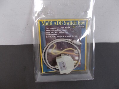

Sort of related… I take it this is an example of the old “passive” deign of ADB KVM:
Macintosh Multiple Monitor / ADB Sharing Box / Mac Quadra / No Cables /Like New. Shipped with USPS Ground Advantage.
www.ebay.com
Also on a related note, I just found this ADB switcher and will try it in reverse by hooking up the wired end to the keyboard.
Can connect three ADB devices. Mouse Joysticvk Keyboard etc. For sale is one Multi ADB Port Switch Box for Macintosh.
www.ebay.com
