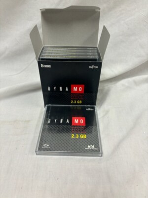

Posted by: MrFahrenheit on 2023-11-07 03:26:22 If anyone is looking for some 2.3GB blank media, this listing on eBay is the cheapest I’ve seen them in years:
New sealed Fujitsu Dynamo 2.3GB rewritable magneto optical disks 5pk. 388811. 3.5" rewritable magneto-optical disk(unformatted)
www.ebay.com
That’s about $8/disc. In 2021 when I got into these, the cheapest was $20/disc. And I hadn’t found anything much cheaper since. |
Posted by: olePigeon on 2023-11-07 08:26:34 That's the cheapest I've seen 2.3GBs in a long while, probably why they're selling fast. I payed $5 per disk for mine a few years ago. |
