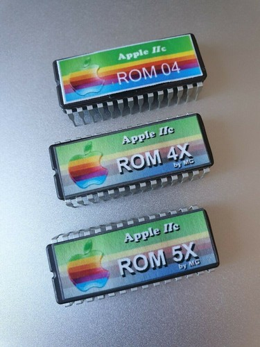

Consider upgrading the ROM, you can find kits on eBay and elsewhere. You'll need to upgrade beyond ROM 255 in order to use Smartport hard disk images like Total Replay. A ROM 4X is a great upgrade:
apple2.guidero.us
Yes I do plan on doing this at some point! However it looks like that's about $80 and requires some soldering (which I am very bad at), so I'll have to build up the courage for that 🙂 |

Yes I do plan on doing this at some point! However it looks like that's about $80 and requires some soldering (which I am very bad at), so I'll have to build up the courage for that 🙂 IIRC it’s one trace to cut, and one bridge to solder. The soldering is the easy part! It does not require any precision. Cutting on the other hand: you don’t want to slip! But it’s not in any way delicate work.
And don’t pay 80 dollars just for one programmed ROM chip. It must be more like $20. I bought mine here:
Les meilleures offres pour Apple IIc / IIc+ puce ROM 04 / ROM 4X / ROM 5X sont sur eBay ✓ Comparez les prix et les spécificités des produits neufs et d'occasion ✓ Pleins d'articles en livraison gratuite!
www.ebay.fr
(I’m sure you can find a vendor in your country) |
Posted by: Skate323k137 on 2023-09-19 08:01:01 I have plenty of 25C256/512 chips, I can burn the chip(s) for ROM4X or ROM5X for you for $10 each plus US postage (usually about $4). A little more expensive if you want a non-windowed SST SF EEPROM that can be rewritten without a UV eraser. If you don't plan on reprogramming it, a normal EPROM is fine. |
Posted by: bigmessowires on 2023-09-19 08:01:20
ROM 00 is $15 here: https://www.ebay.com/itm/175608327181 That's what I have, and it'll get you going with Smartport hard disks.
There's no "serious" soldering involved. See my walk-through of my own IIc's ROM upgrade here: https://www.bigmessowires.com/2015/05/29/apple-iic-rom-upgrade/ Cut one trace on the PCB, and add one solder blob to a giant solder bridge on the PCB. The solder bridge is huge and impossible to mess up. 🙂 |

Yes I do plan on doing this at some point! However it looks like that's about $80 and requires some soldering (which I am very bad at), so I'll have to build up the courage for that 🙂 is there anyone near you that can help? Someone with a desoldering gun and an EEPROM writer wouldn't be too bothered about helping. It shouldn't take more than a few minutes. Take longer to drink their coffee.
Edit - from other responses, it sounds like you don't even need to desolder the chip, so you only need to make them half a cup of coffee 😉 |

There's no "serious" soldering involved. See my walk-through of my own IIc's ROM upgrade here: https://www.bigmessowires.com/2015/05/29/apple-iic-rom-upgrade/ Cut one trace on the PCB, and add one solder blob to a giant solder bridge on the PCB. The solder bridge is huge and impossible to mess up. 🙂 I just watched a video of it, and I was definitely thinking it would be harder than it actually is! Nice big spot to use way too much solder on 🙂
I was afraid it would be much tighter, with bodge wires etc, but I can definitely do this!
Edit: Just realized I had missed your guide, which already explained this 🤣 Sorry about that!
