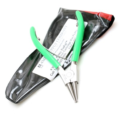

Got me that tool that allows you to open the cartridge. Only $5 🙂
Hopefully it will be easier to open the cartridge.
Let me know as soon as you try it out, if it works I'll get one as well.

Also, if you wanted to ever sell those pliers, let me know (Or let me know if they work!).
You can get those PinPal pliers on eBay for $8

Does anyone know a current source for those Ames pin pullers? I couldn't find one. Inspired from a great tutorial video about these cartridges I went thru my jar of screws and found one that worked pretty well and I was able to pull the tabs out without damage.
