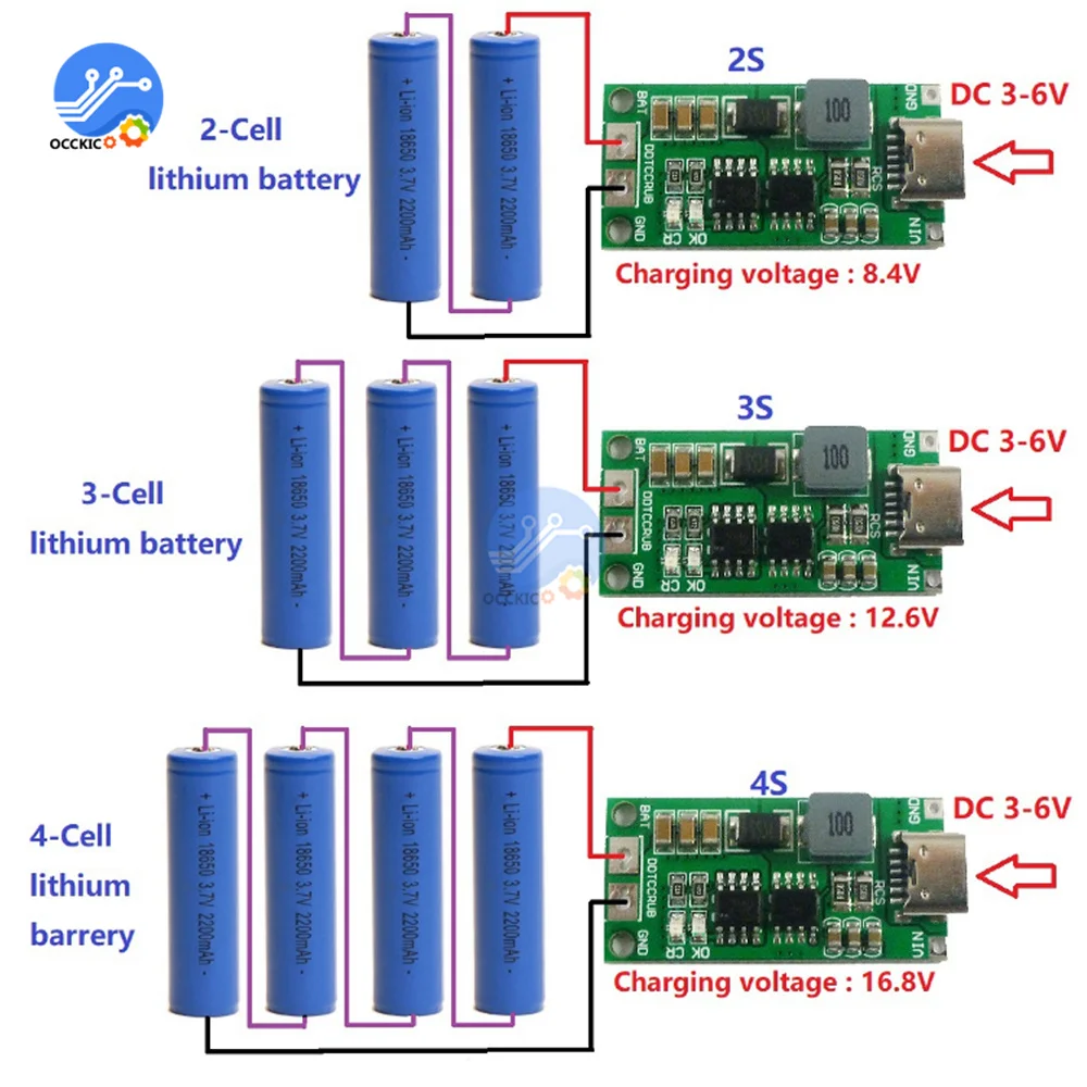

Thank you for all the information and insights. I am trying to make a Powerbook 100 battery as well. I hoped that perhaps 3.2V LiFePO4 cells would be compatible with the charging voltage, but they don’t have enough voltage to run the Powerbook (which seems odd; I thought 6.4V would be enough - I was using two pairs of 600mAh cells = 1200mAh capacity, perhaps not enough current). The low-battery ‘Good Night’ shutdown is triggered as soon as the Powerbook has started up.
So instead, assuming we use 2x 3.6V Li-ion cells, I am wondering; what if the $2 AliExpress BMS is the boost-type, as linked below? It now becomes possible to charge 2x cells from less than 8.4V, but, I imagine it is still necessary to isolate the cells from the Powerbook while they are charged. I guess this is what Sutekh described before.
For the PowerBook 100, would it need another regulator to drop the ~7.5V supply to 5-6V? - or would the PowerBook’s supply ‘see’ the charging load and stay in the controlled-current, lower-voltage phase of operation that seems to be part of its design?
Your thoughts please 🙂
