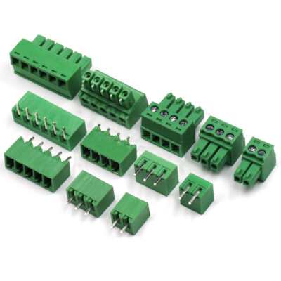

I can't help much concretely with the TPD and FPD cards: I do not have a TPD card and while I do have an FPD card I don't have a cable to actually connect it to anything (nor do I currently have the time or mental health to make one up). If someone can send me a cable to adapt it to a vga-like pinout or point me to where I can buy one, I'll have a look 🙂. | Posted by: Skate323k137 on 2022-09-05 04:02:44 I love extron stuff. I have this HDMI scaler, as well as some sync stabilizers (which can strip sync on green and convert to RGBs or RGBHV (VGA)), the DVI-RGB converter, and some component to VGA and vice versa. If you can come across extron stuff for cheap, which absolutely happens, it's usually worth it. | Posted by: Phipli on 2022-09-07 06:47:32 Anyone in the UK looking for the power connector, I think (not arrived yet) this is the right part :
Pitch: 3.81mm. Screw: M2、Copper、Galvanized. Buckle Material: Brass, Tin plating. Insulation resistance: 500MΩ/500V. Pin: 2/3/4/5/6/7/8/9/10/11/12/13/14/15/16Pin. -Light shooting and different displays may cause the color of the item in the picture a little different from the real thing.
www.ebay.co.uk
10 for £3.94. Make sure you select "Hole Plug" (?!).
P.S. If 9 people want one for the cost of postage let me know. 😛 | Posted by: Trash80toHP_Mini on 2022-09-07 09:55:31
