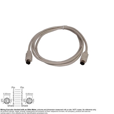

Posted by: Iesca on 2023-03-28 13:50:43 Is this the correct sort of cable required? I tried using the 8-pin to 8-pin cable that went with my Apple MIDI Interface, but that doesn't seem to work.
Model: SKU# 220961A. Apple Macintosh Serial Modem Cable. Mini DIN 8-Pin Male. Male Pin-1 to Male Pin 1. Male Pin-2 to Male Pin 2. Male Pin-3 to Male Pin 3. Male Pin-4 to Male Pin 4. Male Pin-5 to Male Pin 5.
www.ebay.com
EDIT: Doesn't seem like it. |
Posted by: daanvdl on 2023-03-28 13:54:24
www.ebay.com
EDIT: Doesn't seem like it. No, You will need a crosscable: https://airtalk.shop/?product=apple-modem-cable |
Posted by: Phipli on 2023-03-28 13:56:33 All DIN serial cables are crossovers. The cable from the tone module should work. Strange it doesn't. |
Posted by: Skate323k137 on 2023-03-28 14:07:45
All DIN serial cables are crossovers. The cable from the tone module should work. Strange it doesn't. I have straight thru ones but I have them clearly labelled as such.
I use the same cable for an imagewriter II, airtalk, and MIDI module; a crossover. |
Posted by: Phipli on 2023-03-28 14:11:46
I use the same cable for an imagewriter II, airtalk, and MIDI module; a crossover. The straight through ones aren't for using as serial though are they? Or am I being daft 😆 |
Posted by: cheesestraws on 2023-03-28 14:12:36
I've seen straight through ones sold as serial, irritatingly. My only theory is that some samplers use it or something? |
Posted by: Phipli on 2023-03-28 14:14:24
I've seen straight through ones sold as serial, irritatingly. My only theory is that some samplers use it or something? Oh, anything that uses a din cable that isn't a RS422 cable could be wired differently. But any mac serial cable should be compatible. |
Posted by: Iesca on 2023-03-28 15:06:28
All DIN serial cables are crossovers. The cable from the tone module should work. Strange it doesn't. It might be something else in my setup, but it's my current candidate. It could also just be broken! |
Posted by: cheesestraws on 2023-03-28 15:14:34 Didn't realise you were short of serial cables or I'd have sent you a spare! Oh well. |
Posted by: Iesca on 2023-03-28 16:00:03
Didn't realise you were short of serial cables or I'd have sent you a spare! Oh well. I didn't either! Haha |
Posted by: mdeverhart on 2023-03-28 19:01:36
I've seen straight through ones sold as serial, irritatingly. My only theory is that some samplers use it or something? My (flimsy) recollection is that modems used the straight through cables, consistent with the (annoying in my opinion) DTE (computer) vs. DCE (peripheral) designations. Printers and many other peripherals used crossover cables. Point-to-point LocalTalk between two Macs also can use a crossover cable. |
Posted by: Iesca on 2023-04-03 20:58:06 All is well. I acquired an Apple 590-0552-A printer cable and it works! My 2010 iMac is talking to my Macintosh Plus. 🙂 Now, with just about 18k taking a couple minutes to transfer, there may be some kinks left to work out... |
