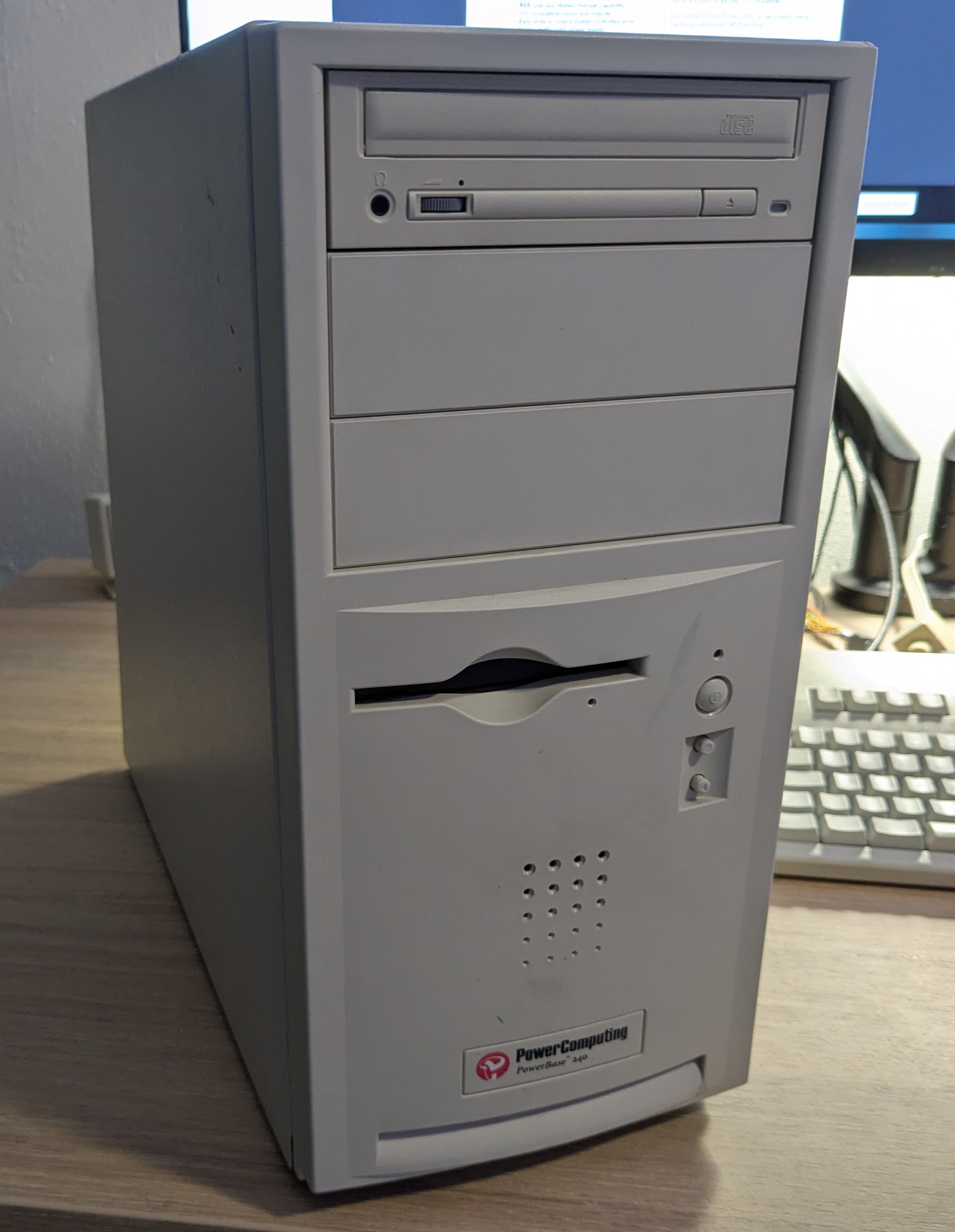

Even though I'm mostly done collecting more Macs (really only after a Blue Dalmatian iMac G3 to accompany one of my Flower Powers), one thing I've wanted for a while now, is a Macintosh Clone of some kind.
I've finally found one for sale on the Dutch Marktplaats classifieds site, a Power Computing PowerBase 240:

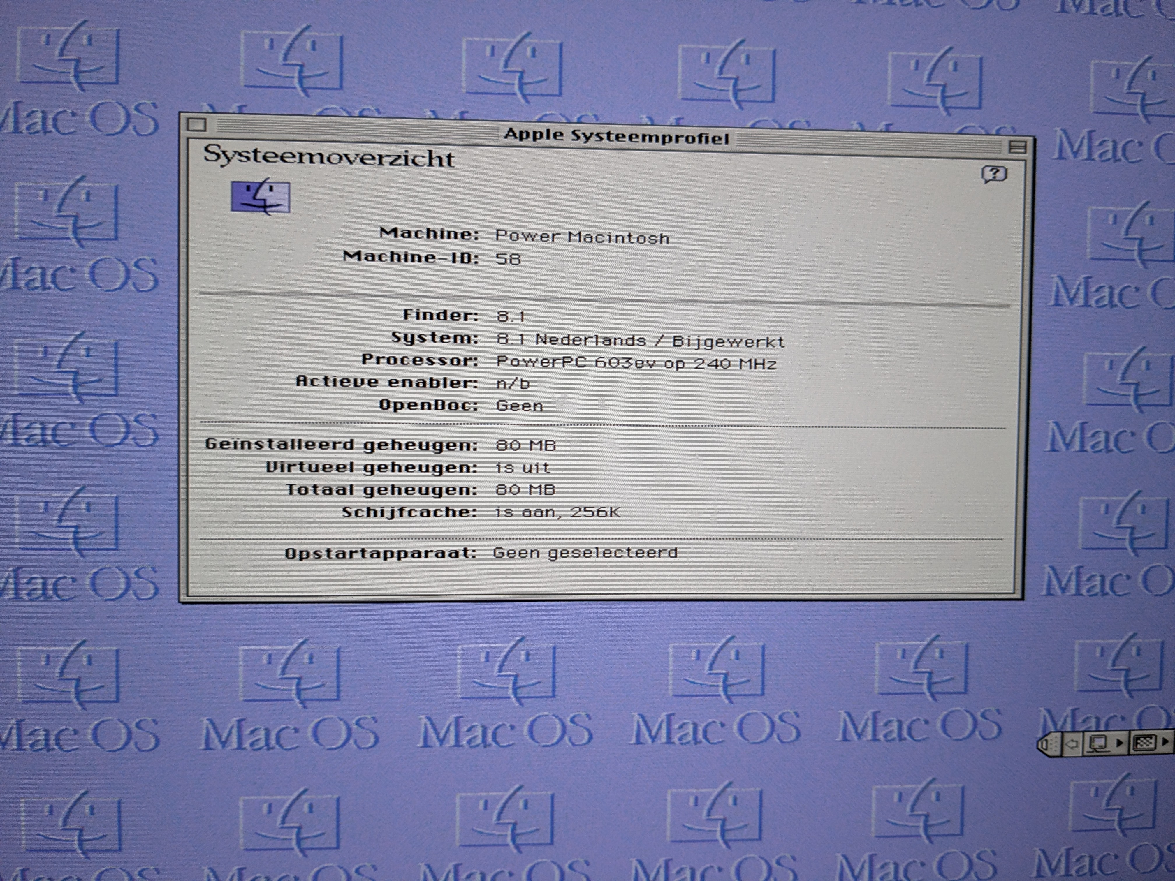

It's based on the Alchemy logic board design, as found in the Power Macintosh 5400 and 6400, though it has a removable CPU card that is somewhat compatible with the slot out of the Power Macintosh 8xxx/9xxx series (some third party accelerators had DIP switches to make it work on both).
I got it for 35 euros plus shipping, it was sold as powering on (chimes) but not outputting video, which he believed might be due to the dead PRAM battery.
No video due to a dead PRAM battery is a thing with the Tanzania machines, but as mentioned, this is actually an Alchemy machine, so this shouldn't occur.
The seller initially told me he'd try it with a PCI video card if he could find one, when I bid 25 euros (the minimum he set), but then counteroffered me 35 euros a few days later without mentioning if he tried it or not.
Once it arrived, it ended up just needing some deoxit and a reseat in the RAM slots.
Really happy to add a Clone to the mix 🙂

Posted by: joevt on 2025-12-17 12:59:56
Get the ROM checksums from Open Firmware to see if it's an exact match to the Apple ROM?
https://tinkerdifferent.com/threads/apple-network-server-macos-based-roms-found.4756/post-41390
