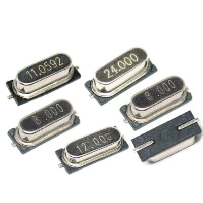

My crystals arrived, ordered off eBay. Doing the trick @obsolete described as I could only find through-hole 50MHz crystals, I ordered some SMD 48MHz to cannibalize. Links below.
Progression of stealing the plastic base from a SMD 48MHz crystal on the top and adding it to a through-hole 50MHz crystal on the bottom. (sniping off the excess leg length not pictured πŸ˜› )
Through-hole 50MHz crystal (Qty 5) - $3 w/free shipping
SMD 48MHz crystal (Qty 20) - $4.99 + $3.50 shipping
If you are able to reuse the plastic piece from the original crystal or are able to solder it on directly you of course don't need the later to cannibalize.
