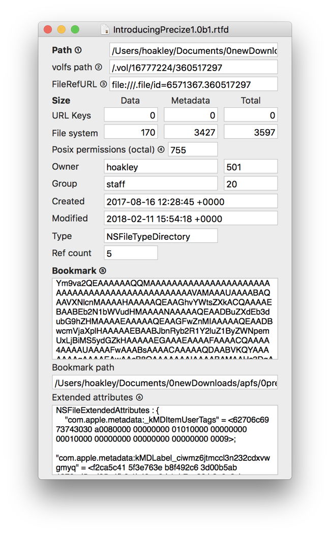

Some apps track old documents wherever they go; others lose them if they are put in a different folder. Here’s why, and some new features for the next release of Precize.
eclecticlight.co

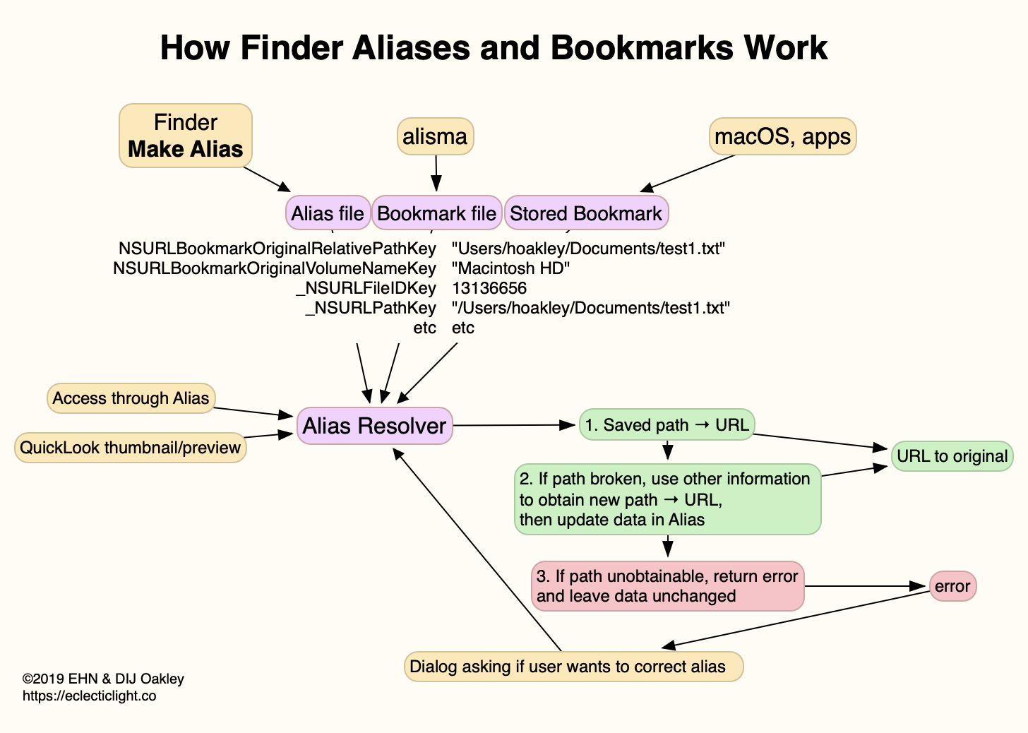

Diagram summarising how Finder Aliases work, including their resolution. And how to confuse QuickLook thumbnails.
eclecticlight.co

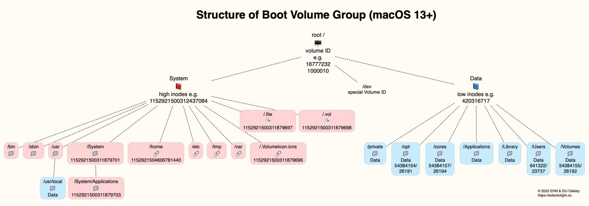

How inode numbers can give important insights into the structure of the conjoined System and Data volumes, and help you navigate them.
eclecticlight.co
