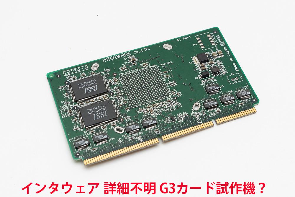

I looked at some photos of CPU upgrades for the PB1400...
We have these two from Interware and Newer, both have 750s and CPLDs.

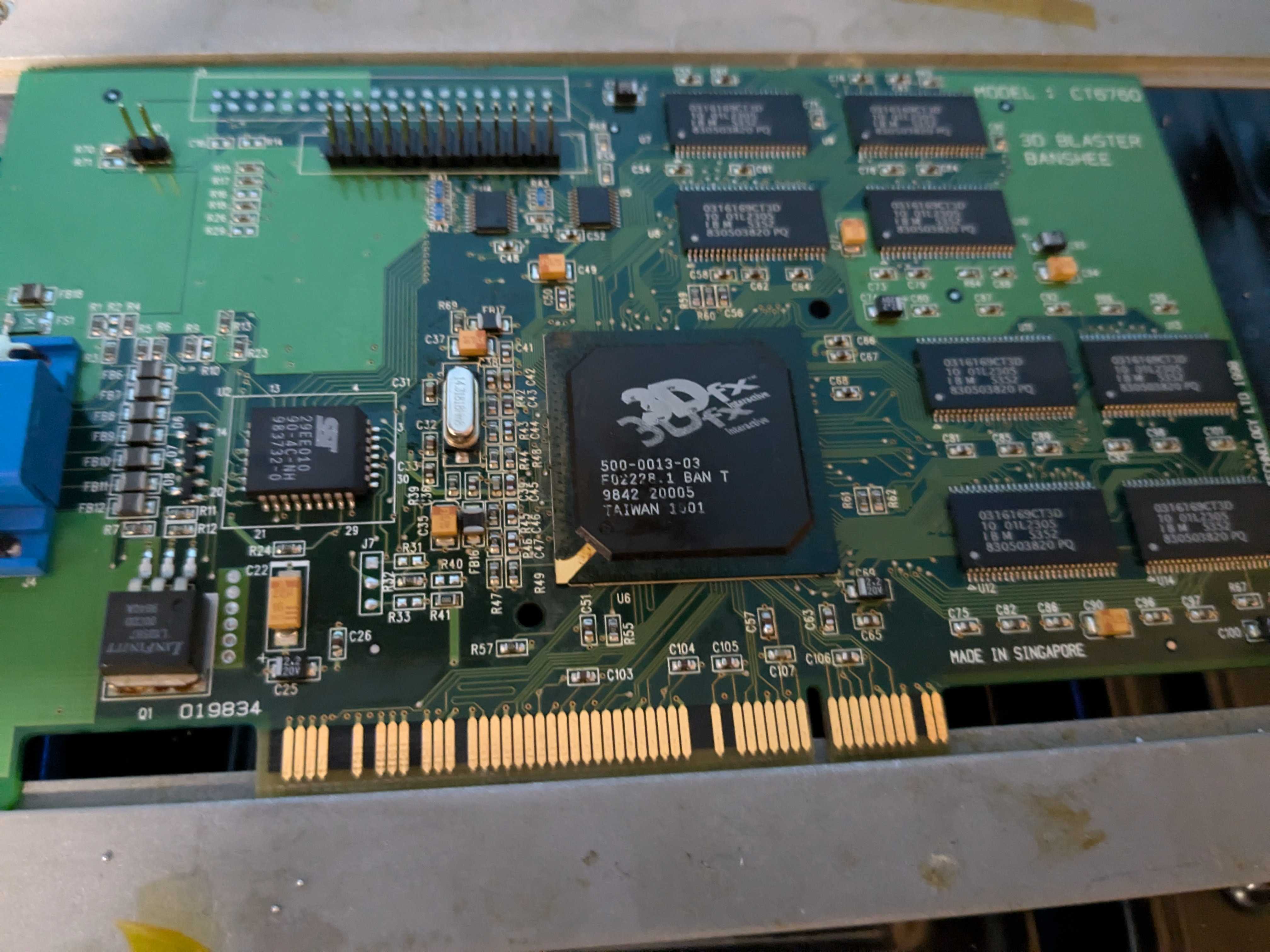

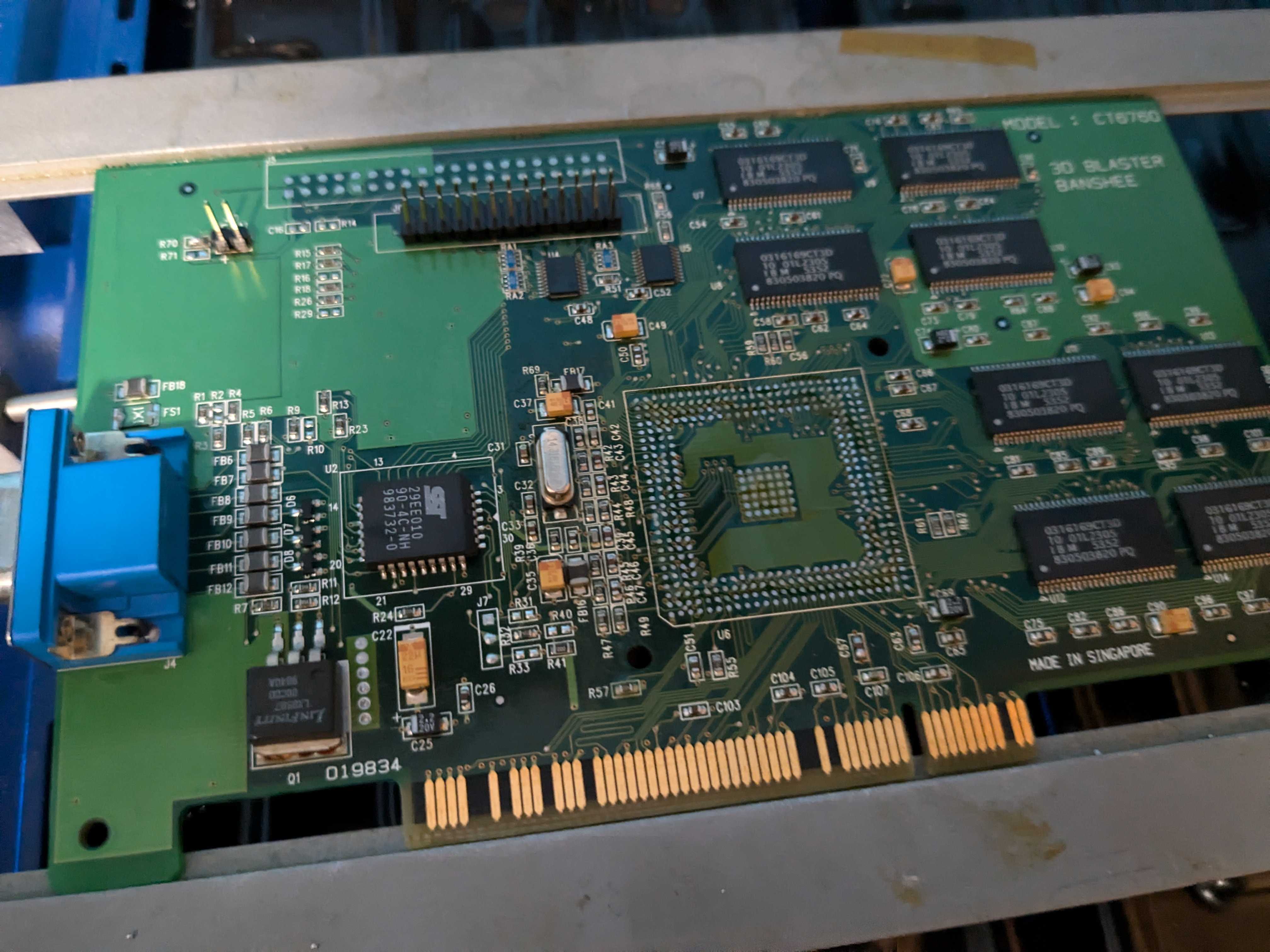

This weekend, I reballed the PCI Creative Blaster 3DFX Voodoo Banshee a colleague gave me to try and fix.
The card had artifacting issues on cold boots, that would slowly fade as the chip got hot.
Once properly hot, Glide games worked just fine (starting them while the card was still artifacting would result in garbage output and crashing), but to me that indicated poor solder connections under the chip.
With how poorly these chips were cooled with piddly little heatsinks (the PCB had significant discoloration on the area of the PCB under the chip), I guess the PCB has been bent from the large temperature swings, causing cracked solder balls that expand and reconnect due to thermal expansion when the IC gets hot.
I did attempt a simple reflow before this, but that resulted in fully corrupted graphics in the BIOS, so that didn't do the trick.
I also tried a cheap Chinese replacement chip, but once soldered on, it didn't even get hot and had no output, so it's either a fake or already dead.
So, I pulled that chip back off, and practiced reballing it as the chips I've been reballing before were all ceramic BGA chips (PowerPC processors) rather than plastic BGA chips, which are susceptible to popcorning if not handled correctly.
After that went well, I finally went ahead and reballed the original IC, and soldered it back onto the card.
An initial test, after giving the PCI edge connector a good clean, results in a clean picure in the BIOS, free of artifacts.
I've still got to test Glide games, but this is a very good sign already.

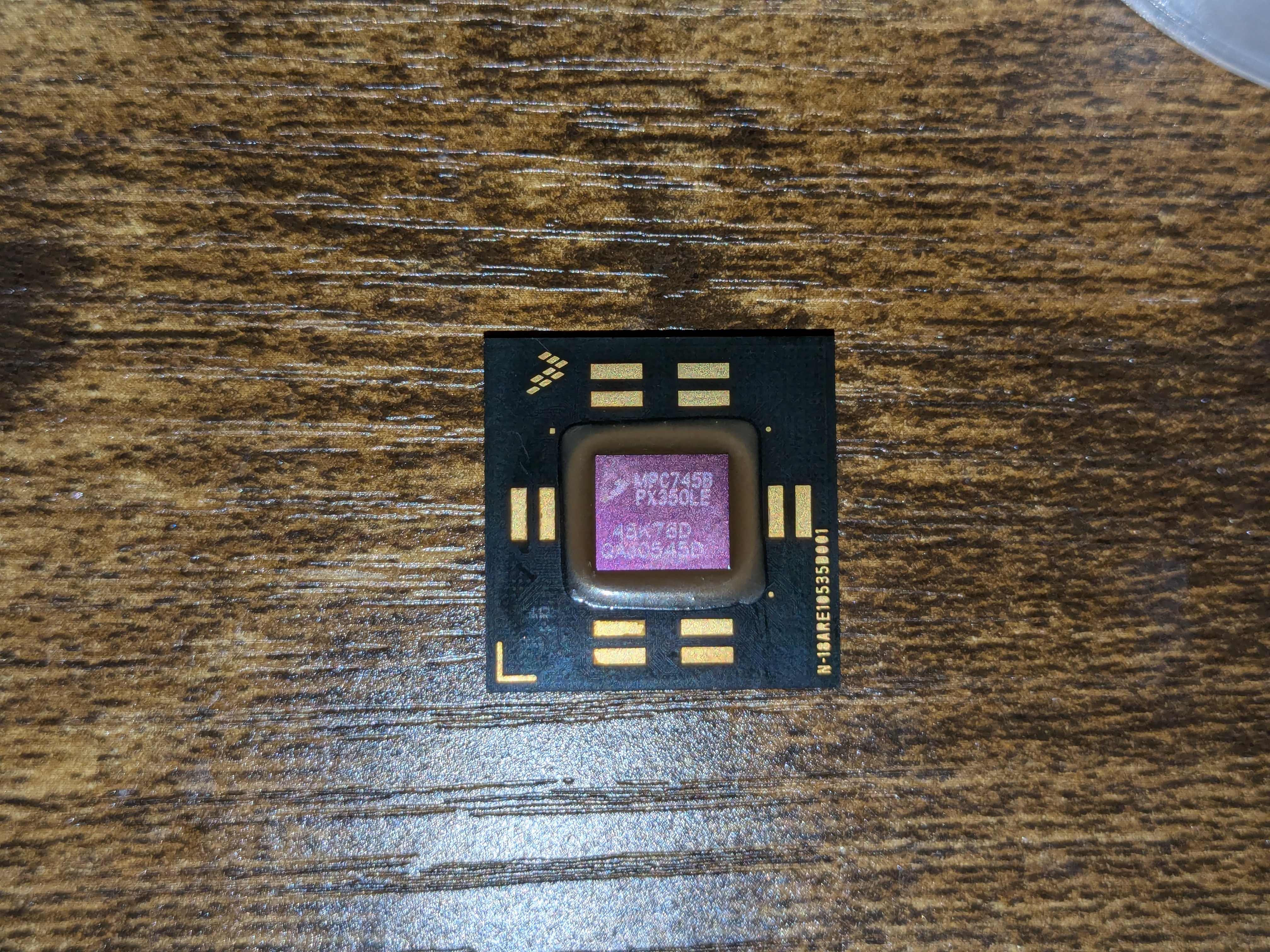

A parcel arrived today, and despite the curious name of the AliExpress seller I got these from, an actual MPC745BPX350LE showed up, though I was surprised this is a dark green, near black PBGA rather than the bright green PBGA in the ad.
Though, then again, that was a different part number (MPC745BVT300LE), but I had no reference online as to what this one should look like.
Very nifty chip, hopefully it can serve a 32-bit data bus only 603e Macintosh at some point in the future 🙂

One question, can you be confident it's not remarked?
I'm pretty much 99% certain it's not.
If you look at the faked MPC/XPC106 chips, they were polished to a clear mirror shine, then re-engraved.
This looks like factory Motorola/Freescale engraving, typeface wise, and it's still got a matte, purple-pink finish to the die.
I would imagine it would be more glossy, if not entirely clear, if they had polished the die for re-engraving, with less legitimate looking engraving. | Posted by: Daniël on 2024-10-07 00:14:51

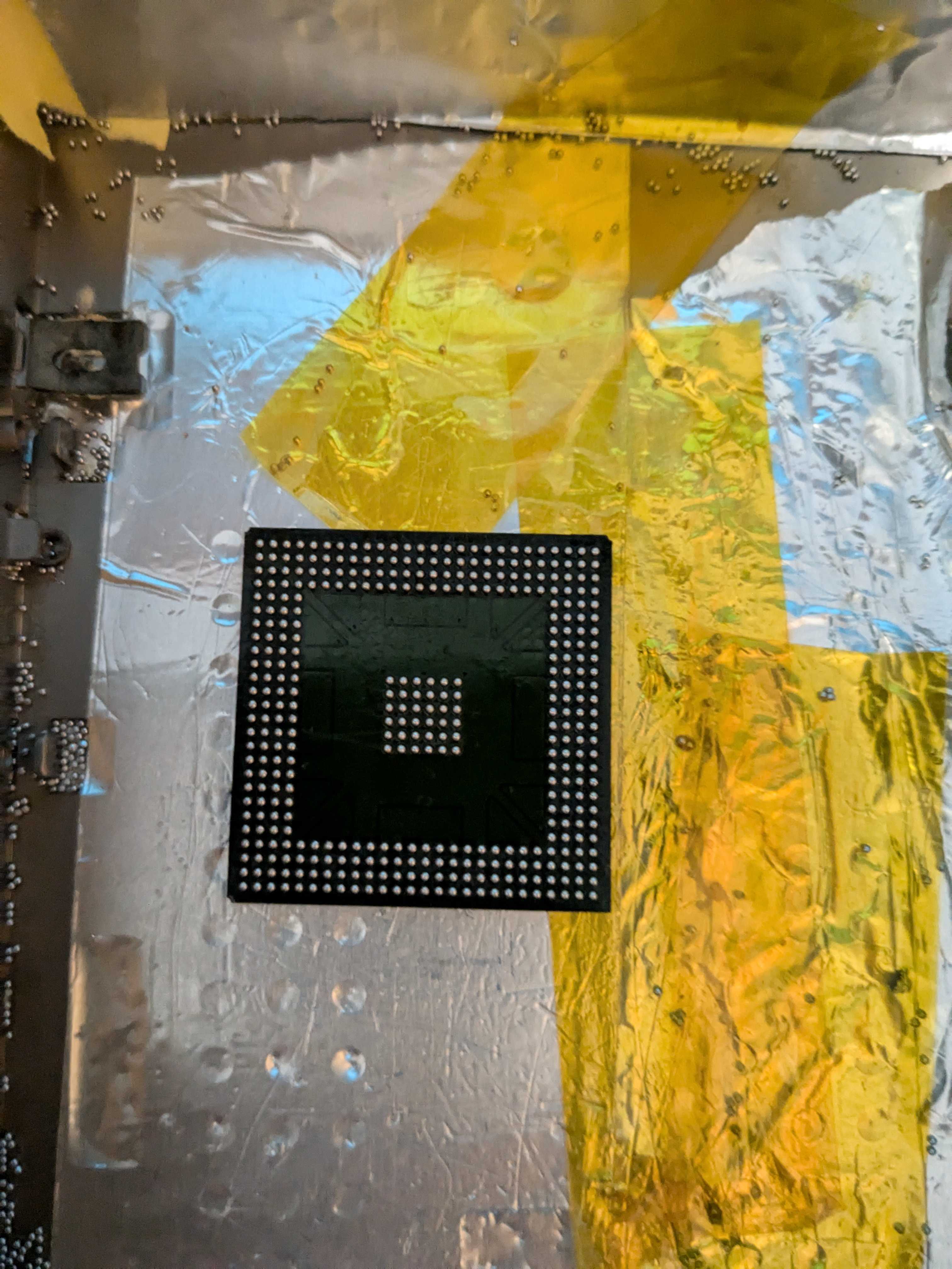

It does seem like it's all reballed with .76mm balls (which the 745s normally come with, but the 7410s do not), and it might be lead free as I find it doesn't melt very well.
I would recommend reballing before using them, which makes the 7410s less appealing as you can get them with leaded balls for $30-ish on eBay still, but I haven't found a source for these 745s elsewhere. | | < 2 > |
