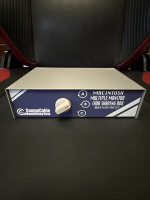

Posted by: LaPorta on 2024-08-23 17:15:19 Maybe I’m just a simplified idiot…but isn’t the easiest way to switch things an actual switch on the box, or even a remote switch? |
Posted by: saybur on 2024-08-23 17:37:18 It's definitely the easiest way, but unfortunately the design of ADB makes things a bit more complicated:
- Devices get reset during computer startup. If you don't participate in that process the device will likely not work with the computer properly.
- ADB devices all have a changeable bus address. This follows a semi-random routine during reset. If all you have attached is a keyboard and mouse they generally remain at a default, predictable bus address, but if you have more than one device of a given type their locations on the bus can be random and switching will not be reliable.
- There were apparently issues with mechanical switches losing the mouse and needing a separate program (ADB Renewer) that had to be launched from the keyboard.
The idea with the software-switch approach is to fix these problems by virtualizing the communication: even if a Mac is not the selected computer on startup, Hootswitch is pretending all the devices are there and handles all the required steps. If you switch away from a computer in the middle of a communication session, it looks to the computer like all you did was take your hands off the keyboard/mouse - they'll continue to respond to required messages if needed.
Basically, you can kind of get away with mechanical switches for very simple setups, but it was still quirky. |

Posted by: pl212 on 2024-08-29 23:19:19 Sort of related… I take it this is an example of the old “passive” deign of ADB KVM:
Macintosh Multiple Monitor / ADB Sharing Box / Mac Quadra / No Cables /Like New. Shipped with USPS Ground Advantage.
www.ebay.com
Posted by: saybur on 2024-08-30 07:33:33 Yup, it is. Didn't last long at that price either! |
