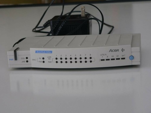

Posted by: jimjimx on 2023-05-02 18:42:44
One seems to have a modem of some kind. Looks like a bnc connector/serial port?
One of the easiest things to do, to get the network working with modern equipment, is to get a old hub with BNC, like this..
You'll also need a BNC cable..
